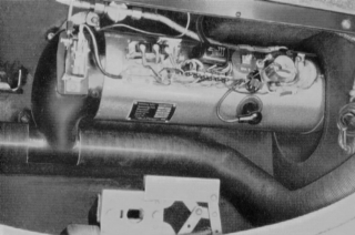

      The heater hole fits the Eberspacher gas heater.
        John, I think that the top photo shows Heather's bubbles, a plural.
