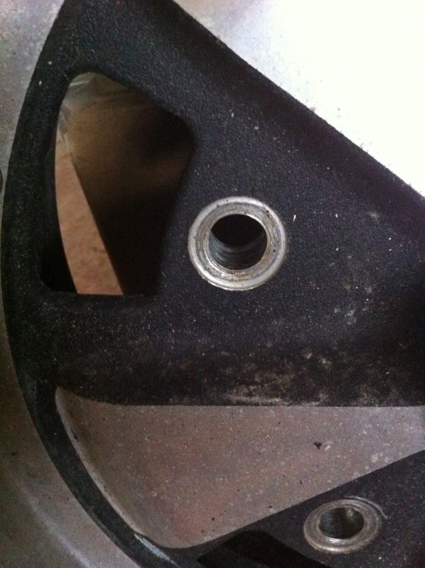

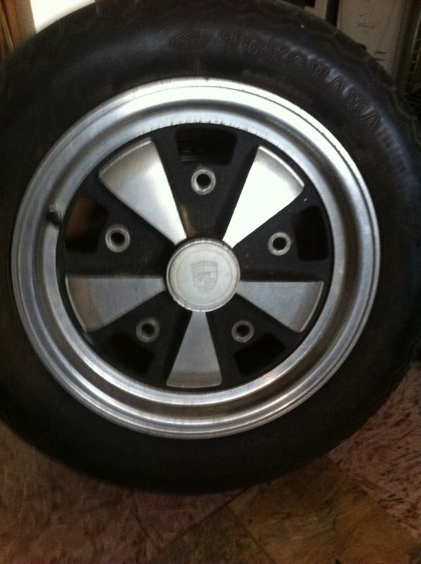

    A million years ago my brother sent me a set of wheels off his 63 coupe. The are Drum Brake Fuchs looking casting made by AWE 5.5X15 (see photos). Not having a need for them, I just left them in the cardboard shipping boxes unopened. Now after many moves I can not find the lug nuts for them.
    The face of the wheel looks like the lugs are flat or had a washer?? There is no taper or radius The Hole is 17.5mm and the washer spot face is 29mm. Did that have an insert to a sleeve under the flat?
    Does anyone have a set of these wheels or a lug nut they could photo for me.
    Thanks
    Figured it out. Found a source for the nuts, just need to turn them down .040. They are American eagle wheels (AEW) Thanks

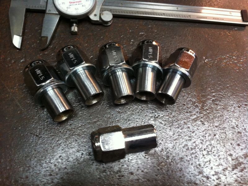

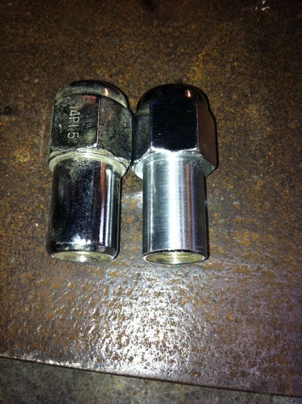

        Found some in the old junk stuff bin at the local Les Schawb tire shop with the correct pitch. They were all 0.125 too large and from 0.250-0.750 too long.
        Well then made up a fixture, cut them down to 0.0025 smaller than the wheel hole, shortened the to .050 less than the hub thickness and presto. They are a pain to line up, and get started but when finger tight, no wobble at all.

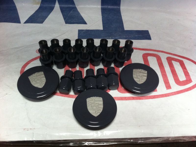

            All the nuts I could find were too long and too large in diameter. I found some 1/2" that were close but the 14x1.5 are out of production. SO I cut them down to fit, shortened them, then powder coated them and the centers to match the car. Just a fun day in the shop.

                  Yea. Hard to find, Tell me. But after a little mod,
                  they work.
