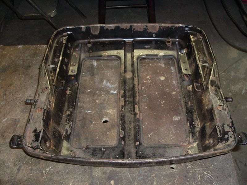

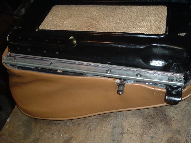

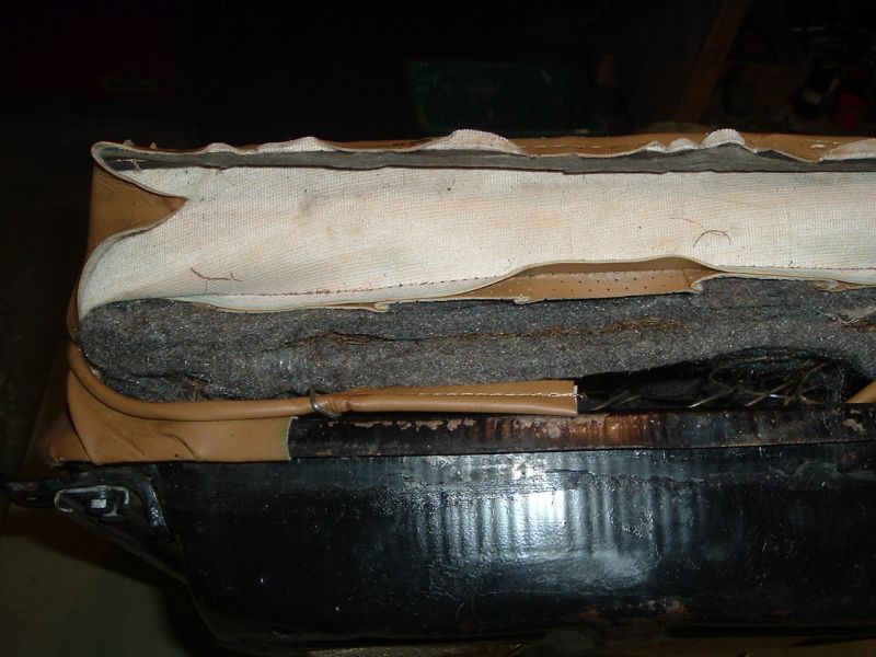

      Ashley,
      They aren't floating plates. If you look at the combined photos you'll see the tab is bent and riveted to the seat pan on it's side then bolted thru the rail. Sorry I don't have clearer views but these shots are from when I rebuilt my seats during the winter. Hope they help.

        Thanks Don. That tells me what I needed to proceed. This afternoon I got some M7X1 screws and also M8X1 just in case. I think the stripped 6mm threaded holes that remain are close to the 7mm tap drill size and should easily clean up with the tap drill. That's what I am going to try. Will report back with, hopefully, success! Thanks again for the time to post the helpful pictures.

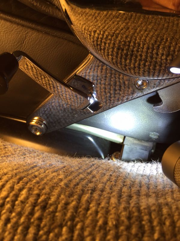

            Thought I would follow up on this repair. Hard to get a picture with a phone that shows the problem but you can kind of see the seat rail part that attaches to the seat is bent down in the back. In this case I don't think the back two screws that hold the seat rail to the seat were ever installed as they were not in the car loose and they physically could not come out of the tunnel side as there is no room. On the tunnel side the rail cannot bend down very far because of the tunnel. On the door side it can bend down a lot as there is nothing under the overhang to stop it. The seat catch riveted to the seat bottom pan relies on those two bolts for 90% of the support and the rivet maybe 10% as it's into sheet metal and off to one side.
            I have had the problem virtually since I put the car back on the road and the seat back was always slanted a little to the door with limited adjustment. Might be imagining it but I seem to remember the seat problem in the early 80's when i drove this car every day.
            The fix:
            You cannot get the seat out of the car if this happens. It has to be at least partially repaired in the car. On the drivers side the two 6mm screw holes seemed stripped so I drilled one of them to the m7x1 tap drill and tapped it 7mm. Once I had that screw tight I was able to move the seat far enough forward to then get in the back seat and push it all the way forward to finish removing the screws and remove the seat. After that it was a quick fix to tap the other hole 7mm and straighten the two rails. The two threaded holes on the tunnel side were not damaged. The rails are soft and easily formed.
            The passenger seat had the same issue but to a lesser degree. Plus all the threads were still good in the back two holes so no drilling and taping.
            One nice thing, looking under the seats, the shop that did the interior did an extremely nice job even in the areas you can't possibly see with the seats in the car (except ovbiously for the back screws - but I will give him that one as an honest oversight). I wouldn't hesitate for a second to take another interior job to him.
            Both seats now sit square and adjust easily.

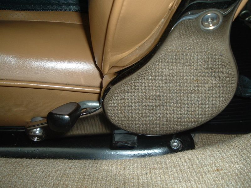

              Hi Ashley,
              From your picture I find your seatback release different from the one on my "C". My chassis # is 220994. Both sides have the same release as the one shown in the picture below. Wondering why the change?
                Hey Don,
                Good question - I don't know.
                Mine # is about 1/2 yours and it's a Reutter chassis.
                Maybe they used more than one seat supplier.
                Ashley Page
                  Mine's a Karman, maybe that's the difference?
