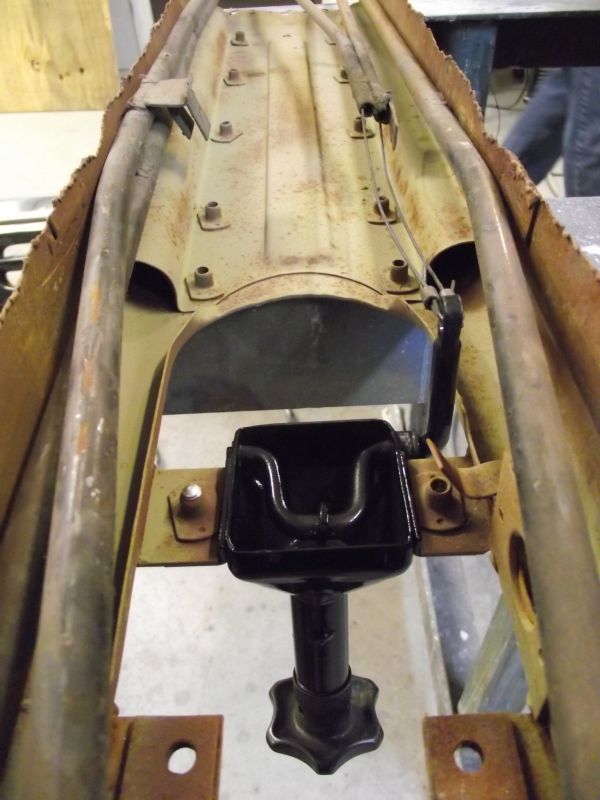

                          I misunderstood this post, I read "heater wires" and dismissed it as something to do with the electrical. I have had these pics for some time as another guy had a similar question a while back. Hope this helps:

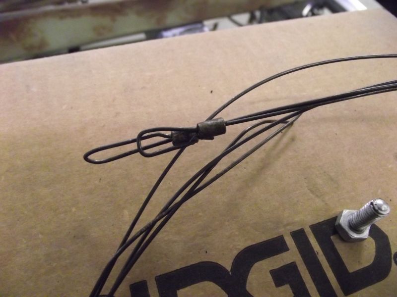

                          Wire is just looped back and a metal collar slides over to secure the end.

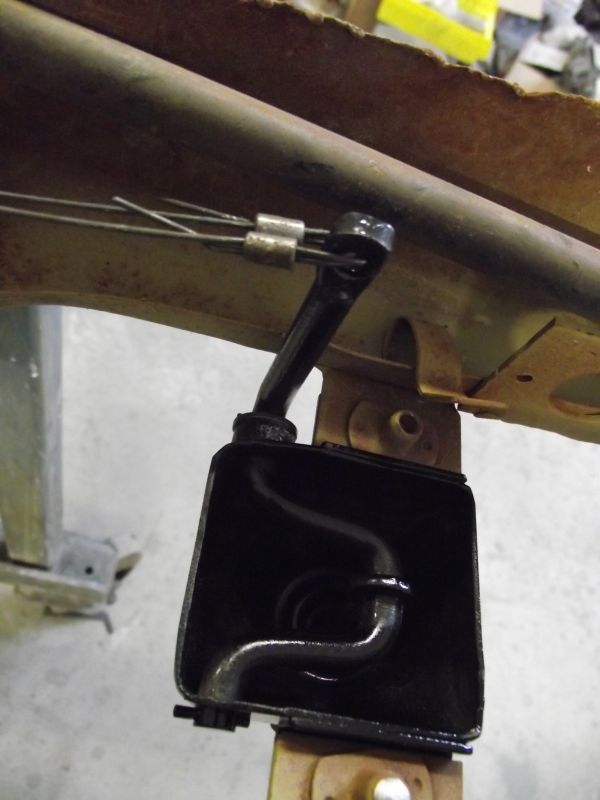

                          Its just a piece of tubing that easily slides over and is not by any means a crimp fit.
