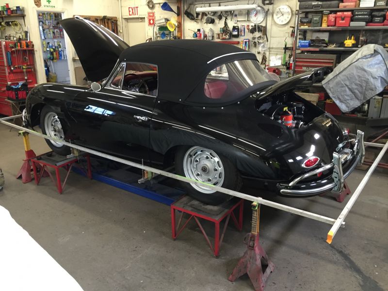

        Here is the alignment method used for checking when a laser rack is unavailable. Used for years on many race cars, accurate enough for a primitive 356.
