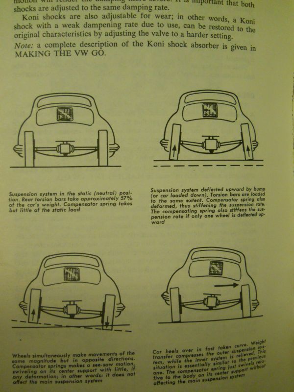

    Thanks for posting this up Stephen. I have been trying for years to wrap my mind around how that compensator spring actually works in there.
    Here is the illustration from my Elfrink manual which I've combed over several times through the years. If its job is to help prevent excessive "positive" camber roll on the outside wheel in a turn I think limiter straps would be far more effective in softening that nasty trait on swing-axle suspension.

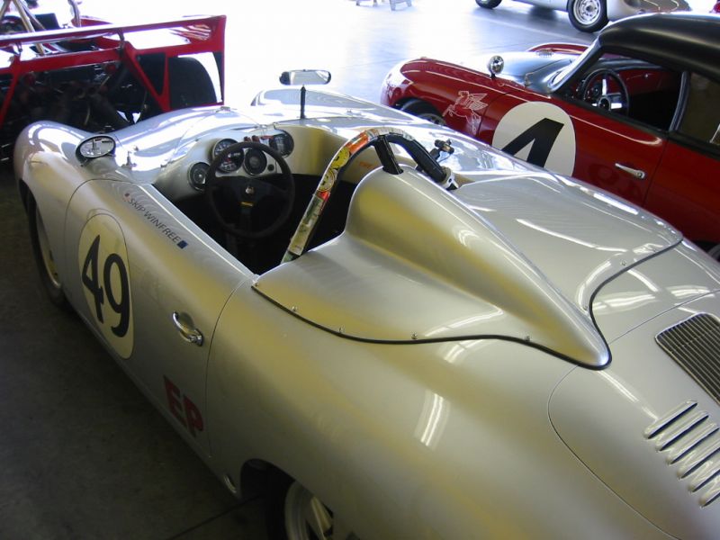

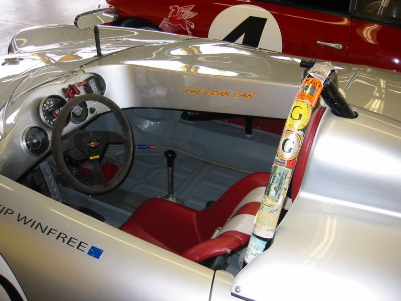

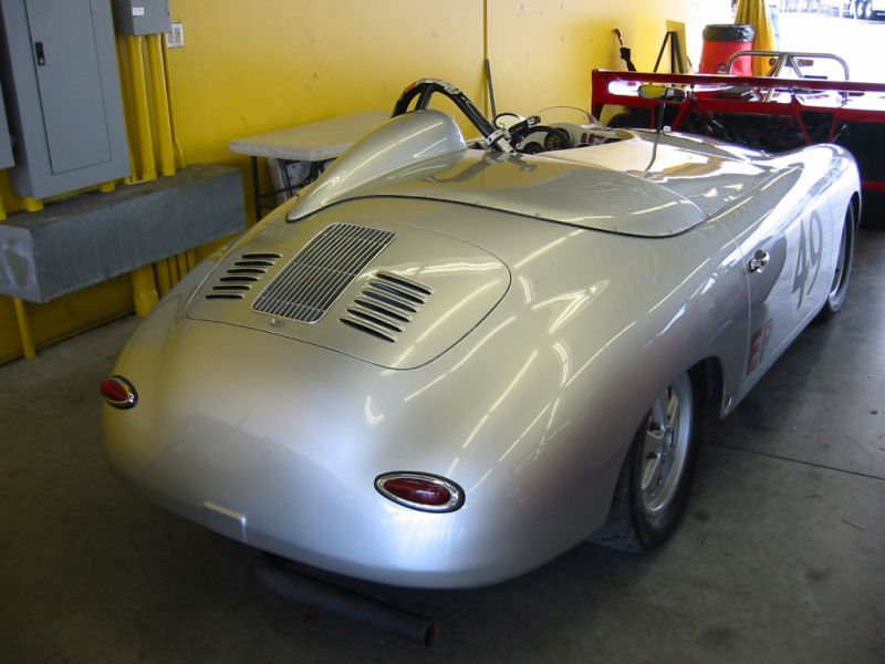

              Roy, in racing there were all sorts of aero aids tried on Speedsters, but in comparison with a Coupe they achieved approximately the Cd of a brick.
              In "vintage" racing, the old Coupes, Speedsters...all 356s....had to weigh the same amount, so the aerodynamics made the difference (other than those who cheated with engines displacement, more frequent than we'd like to know)
              One good thing about Vic Skirmants, who built my motors, was that he would NOT cheat when building a race motor. He was SCCA through and through and 'by the book.' Many a time, I'd catch and pass another 356 "in the twisties" only to have him blow by on a straight and we'd start that all over again...40-over 82.5mm/83.5mm vs 86mm or more makes a huge difference.
              My best motor dyno'd at somewhere around 168HP, the Speedster weighed right at 1705 on each scale. It had the power-weight ratio of a 930 turbo without the aerodynamics or....damn! Torque.

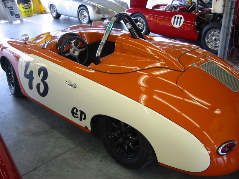

              I found some pictures from a Daytona event. The big thing was to cover the cockpit on the unoccupied side and rear and feed the frontal air up and over the helmeted head of the driver:

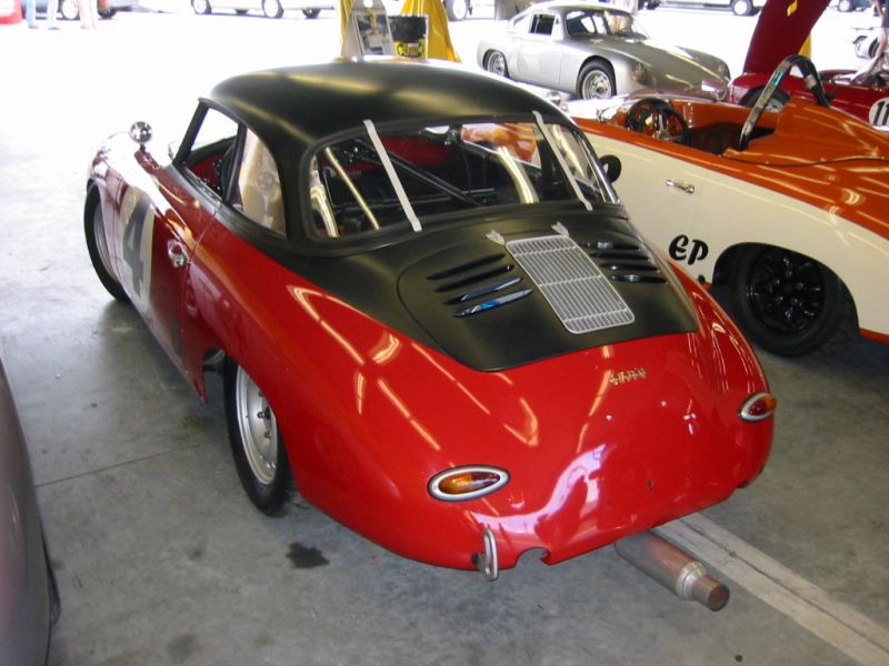

              and then a few raced a Cabriolet with a lightened hardtop.
              Really, the only advantage a Speedster or other open car would have is a lower center of gravity with a max'd track with just the right tires. Too wide and they would induce drag that cost horsepower on a long straight and too narrow, the side friction was insufficient for cornering.
                Thanks for the photos and story. I always thought another advantage of open cars(Speedster) would be visibility. But maybe at speed you don't have that much time to be looking around.
                  Thanks, Phil...more story; I was used to being in open race cars only, as I raced my second Speedster in hillclimbs in the '60s. I realized as I grew older and got into 'vintage racing' that I was becoming more claustrophobic in all ways when confined...if there was no way to control any needed escape, so a Coupe was out. Safety gear didn't count, as I could put it on and knew I could release it if needed. I therefore got my last Speedster to race for the "openness" and not just to look around, but that was a plus.
