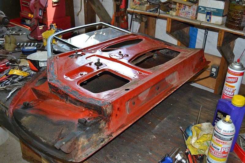

    My doors look pretty good so far, but I won't know for sure until I strip them.

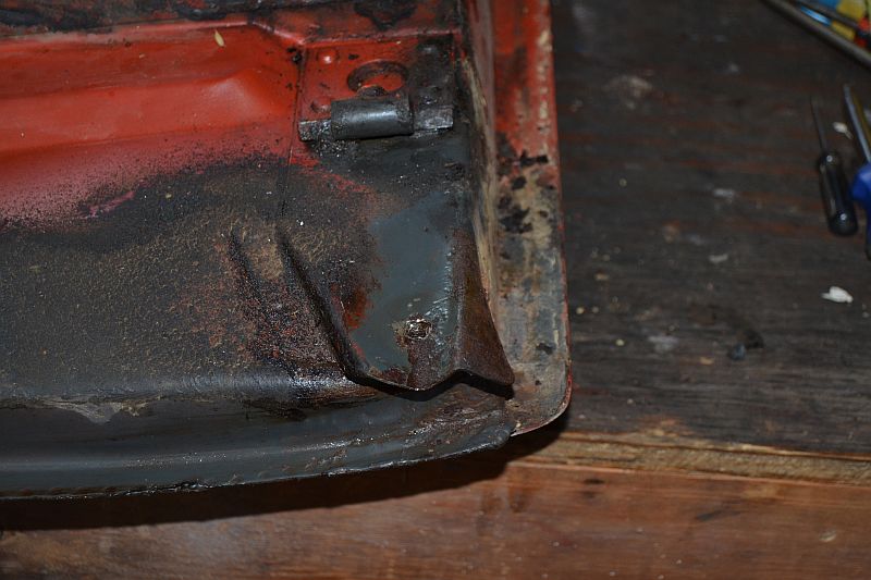

    The door stop mounting bracket isn't supposed to be bent down like this, is it?

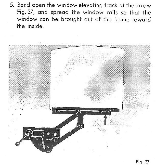

    And what does the FSM mean when it says, "Bend open the window elevating track at the arrow...". If you stick a screwdriver between the window and the track and pry on the track, you would break the window, wouldn't you?

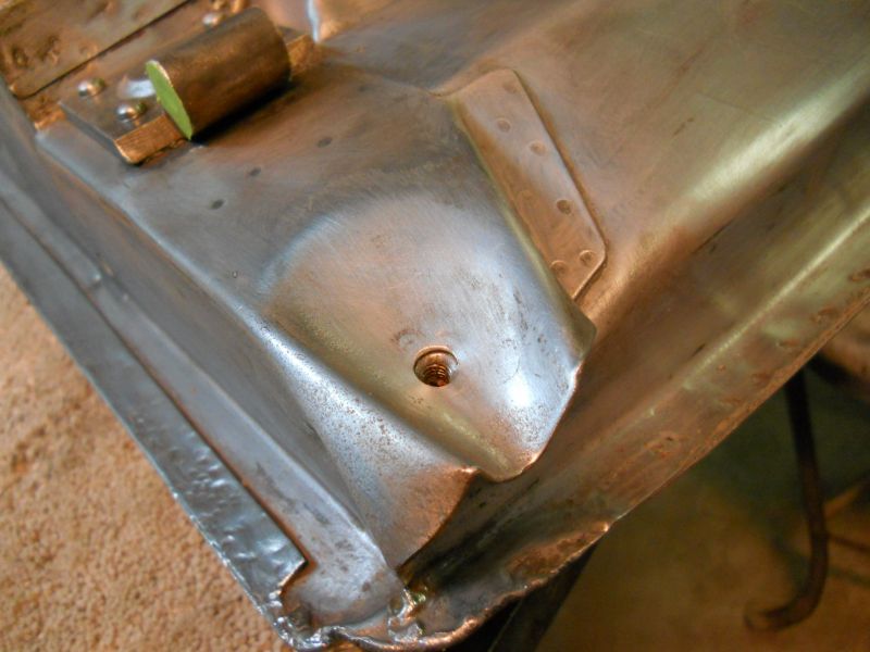

    I can help on your first question. No, the door stop is not supposed to be bent like that. It should be a flat surface where the rubber stop screws in. If you look at Tom Perazzo's thread(SC Coupe Ewatoration) under the "restoration" section you can see how he reinforced his so it would not bend like yours did.

      I don't recommend adding a reinforcement there. It's bent out of shape because the door was forced open too far, at some point in it's life. Better to bend there, than some other hard to repair place if it ever happens again.
      Remove the window frame first, then undo the hardware for the lift mechanism from the door. You will then be able to slide the window track off of the lift.

        Both doors on my coupe are bent exactly like yours William. I decided it best to leave them as they are. They are bottomed out as far as they are gonna go with no danger of allowing the door to collide with the front fender's edge. As a matter of fact the rubber stop has been off the entire time during its restoration and mock up with plenty of clearance between the two with both doors swung all the way open. These are not seen once the car is assembled and it allows the doors it swing just a touch wider while getting in and out. But to be correct they should be flat; your decision.

          Jack, are you saying that the correct window assembly procedure would be to put the latch, glass and window regulator into the door and then insert the window frame last?

              Some take the steps for T-5 or-6 Coupe door glass and frame removal like this:
              First, soak all hardware in Kroil (or alternative penetrant) for a few weeks of marination, especially in the lower regions and the nuts and bolts thereto.
              Gather as many 6mm tools you have in your box; open-end, box wrench, 1/4" ratchet short sockets... and begin to loosen the hardware while becoming aware that what will fit best is not what you have.
              Raise the glass to where there is access to the lift mechanism's roller wheels and "pop" those out of the track on the window's bottom. Something like a screwdriver bent back on itself or a radiator hose reverse pick can work as well for the prying. Don't worry, water-pump pliers 'pops' 'em back in going together.
              Loosen the mounting stand hardware on the door bottom and allow the glass to come out of it's frame guiding tracks, front and rear and lean it against the outer door skin out of the way...OR, raise it up into the frame and fasten it on both ends and top with tape. Then take the brass/chromed frame's hardware (8 bolts) all off and take the frame and the glass together up and out of the door. Separate when lying safely on a blanket on a table.
              Then, the lifting mechanism may be removed and if option #1 is employed, the glass can be taken out on it's side via the top slit or carefully through the lowest inner frame opening. Not a difficult Chinese puzzle, just be aware the tempered glass is soft and can scratch easily.
