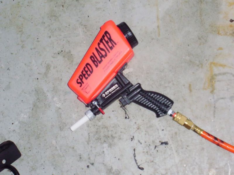

      For the transmission, suspension, wheel hubs, etc. soda blasting also works great. Remove the vent and plug the hole with a thread in plug.
      Soda works really well on virtually every part of the car except plastic lenses.
      It will not remove rust but will take off paint and is great cleaning old caked on grease.
      Very good on chrome too.
      It is water soluble.
      I dangled mine under a forklift and cleaned it with one of these from harbor freight.

      This is a good soda brand which you can have shipped or pick up from a local supplier - google search. I would avoid soda with abrasive particles.
      http://www.armex.com/armex-difference ( their flow formula xl is good)
