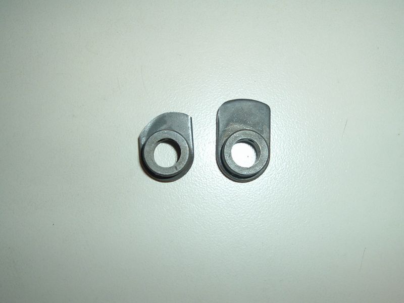

                      My car, a '65 356C, came with old Italian Weber 40 IDF's installed sometime in the early 80's. This car always had the hesitation off idle even after an entire engine and carb rebuild. Drove me nuts tinkering with them. I finally got the guts to attack the roller cam accelerator pump. To say it squirts a LOT of fuel per stroke is an understatement, something over .5cc if I remember. The reading I did for a 356 said it should be down around .1 to .15cc per stroke. After a lot of trial and error, disassembly and assembly, I got it down to .15cc per stroke. Upon reinstallation on the car it ran wonderful, pulls clean from idle on up. I don't know how the previous owners lived with it all those years. If you have the stock roller set-up and are working good I'm amazed!
                      The photo shows the slightly modified stock cam on the right and the final modified cam on the left.
