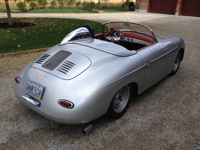

    Here's a link to a recent article featuring Bruce Baker's old racing Speedster now fully restored to hot rod/street specs:
    http://www.providencejournal.com/cars/content/20141122-auto-biography-jamestown-man-s-porsche-speedster-has-been-around-the-track----and-back.ece
    Before
    during
    and today
    What an interesting history and beautiful final transformation Bruce!

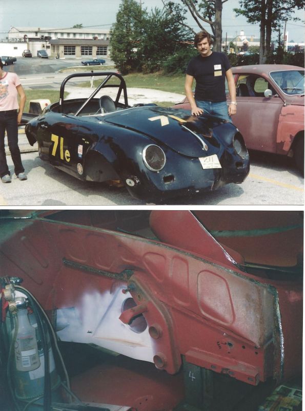

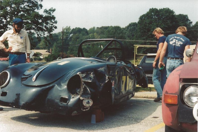

      The proud third owner, Steve Limbert, posing with 84255 c.1980. His prior crash on the left side against a wall in an SCCA race at Bryar, NH put him in the hospital for 3 days with a broken shoulder.
      The SCCA rules changed c.'76 allowing flares for 7" wheels, so for Vintage racing, those had to come off and donor A fenders were put on.

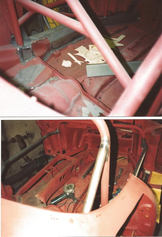

      The old rollbar was removed and I constructed a stronger version, tying together upper and lower torsion bar tubes, front, to the rear...in place of heater tubing and the main hoop to that rear tube, as well...braced well and with side intrusion bars for side impact safety. The dash and front cowl were removed for access.
      I have more construction pictures...I just need to find them.
        Thanks for sharing these old shots Bruce! Yes, the hand on the fender or roof is the surest display signal of proud ownership or possession.
        Love the sub-frame build shots. When you restored this car this last go-around did you remove that square stock and rebuild the stock heat tubes or just leave as is? Thanks again and looking forward to any more you run across! Justin
          Originally posted by JTR70" post=23474
          .......When you restored this car this last go-around did you remove that square stock and rebuild the stock heat tubes or just leave as is?........ Justin
          Left it in for strength. Speedster...heat? The replacement rear torsion tube that replaced the one that got whacked on both sides and bent got welded to that rectangular 2x4 steel tubing on the jig.
          I'll post more pictures as I find them. It's "all original"...at least the floor and both cowls and the dash......and the outer skin of the front hood. The rest? It's really fun to drive and "numbers matching" becomes irrelevant as soon as a wheel turns, doesn't it?

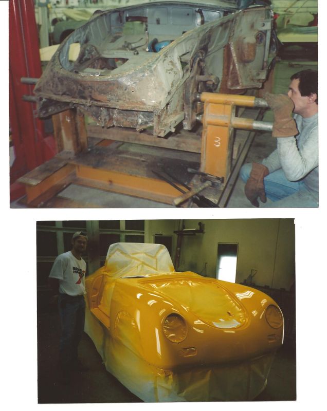

                      Found a couple of pictures of 84255...one is an embarrassing 'nude on the rack' shot making sure the suspension pick-up points are where they belong.....but the other is of Steve Myers right after he painted the shell for me with Spies-Hecker paint. He was a local demo rep for Spies and Spies-Hecker donated the paint for their name on the car.
                        Thanks for sharing these Bruce! I believe I'll be using the same brand of paint on my coupe. Looking forward to any more shots you run across!
