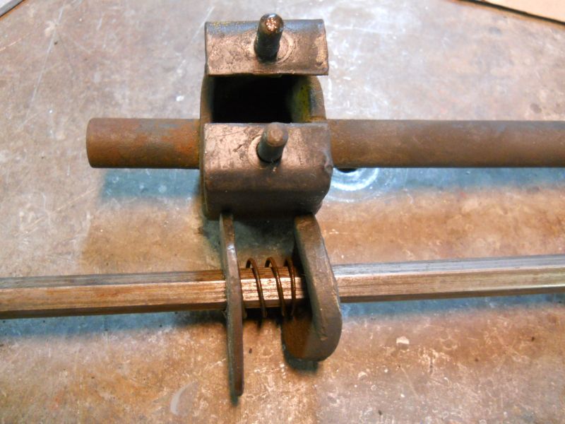

    Hey Gene, Here's a quick description on what exactly is in there comprising the mechanism and how it works as I understand it.

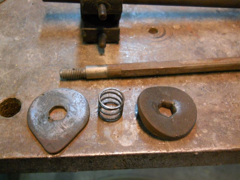

    This is all there is to it, two washers and a spring.

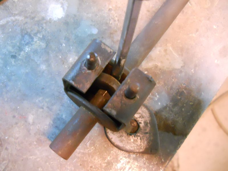

    Forward thin washer has a tab or an ear which is designed to simply limited the rotation of the shaft/handle. Its stamped with an "L" on one side and an "R" for either a LHD or RHD application. The spring just holds the two washers in the correct tensioned position. The big thick bent washer is the actual locking mechanism and works by the same principle as the car's jack.

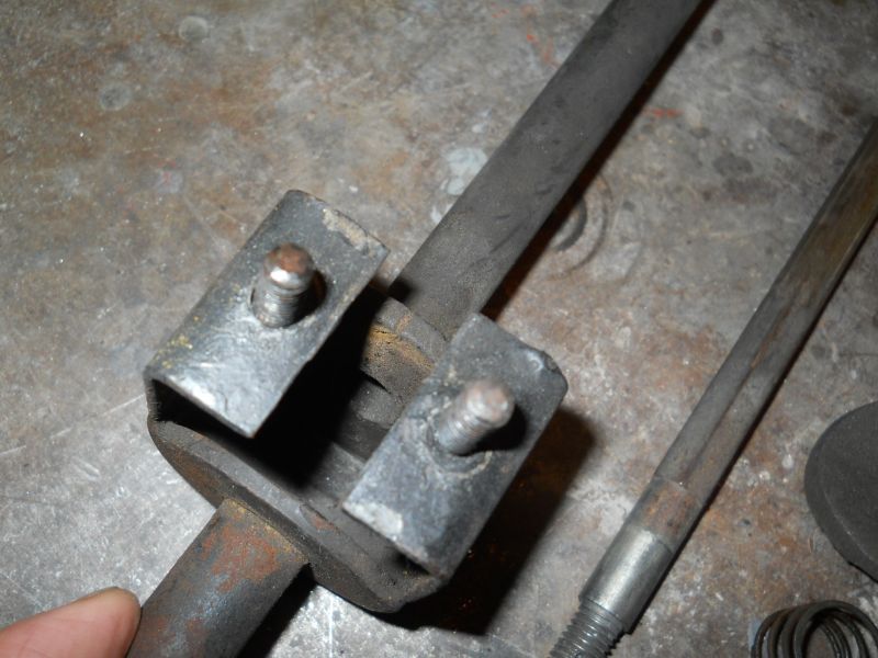

    The Positive side of the "V" profile in this big washer seats against this internal washer mounted in the back of the housing. You'll notice it is set in there at a slight angle so the washer when seated neutrally is always at an engaged "binding" angle.

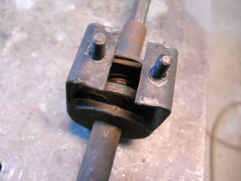

    So at that slight angled approach the shaft is free to move outward to engage the brake but will bind-up if tried to move back in.
    With this in mind you can take a screw driver and try to "level" the washer with the rod by prying the top out just a bit to release the "bind".

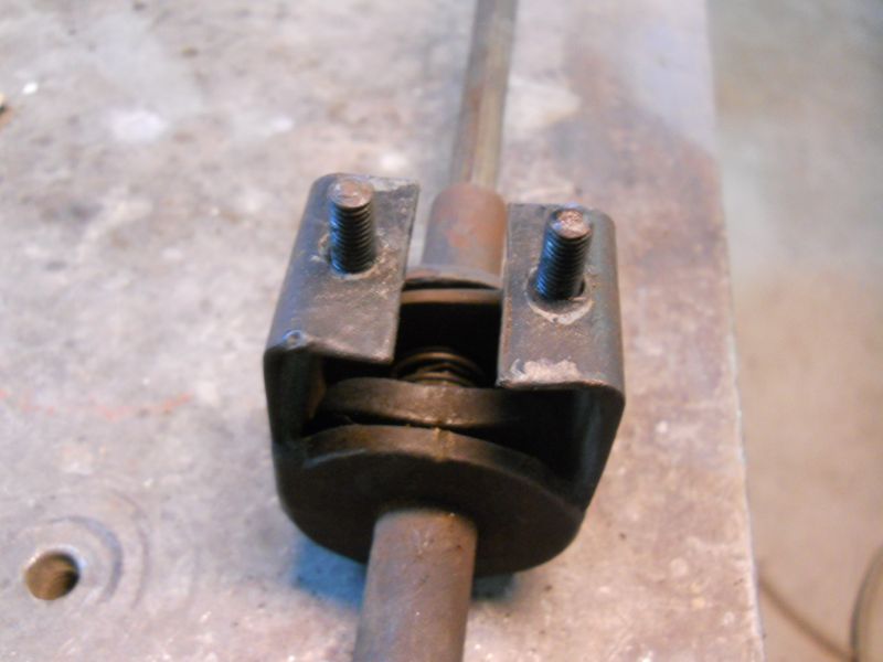

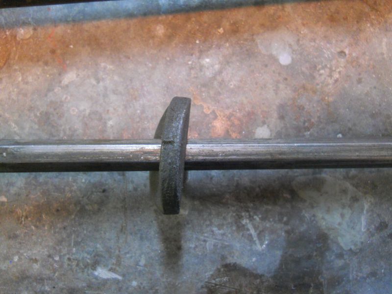

    The above photo shows the orientation of the locking washer in its neutral outward movement only "locking" position. The spine of the bend runs vertical.
    This is the washer now oriented in its free unlocked position; as if you'd turned the handle to disengage. The spine of the bend is almost horizontal. As the spine of the bend runs around the set angled housing back stop washer it pushes its orientation level with the rod releasing the "bind". Hope this made sense. Anyway hope this helps you or anyone else facing the same problem. BTW: Welcome and thanks for joining us here!
