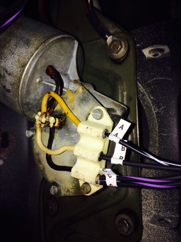

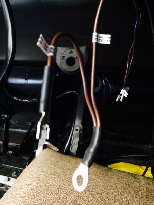

    #21 gr for cigar,gas tankk sending,gas gauge,wiper motor. I see the wiper motor bolt but where does other go?

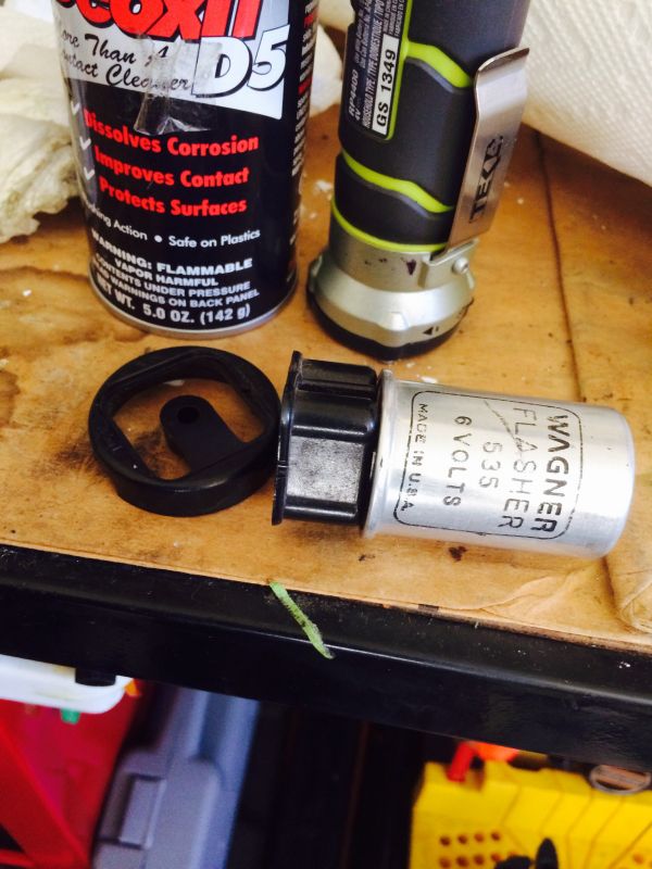

    Also how does this relay attach to under dash area?

        The closed loop goes to one of the 4 bolts that hold the wiper frame to the chassis. The open loop attaches to the wiper motor. Some motors ground with a bullet connector. The flasher unit bolts through the small hole above the hood release tube. Slot screw through the bakelite, with a nut in the trunk compartment. Year and model of car? Your location?

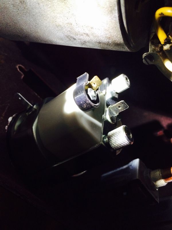

                Little more help
                Which set of nuts for ground?

                  Lester, attach the open end ground to one of the 3 screws on the top pic at 12, 9, or 6 o'clock.

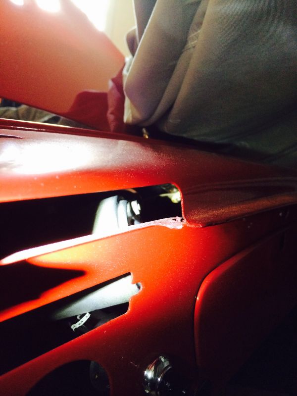

                    Hopefully last puzzle; to clock is a bullet connector? And instrument light to far away for "F" wire for illumination bulb. Maybe not original clock?
