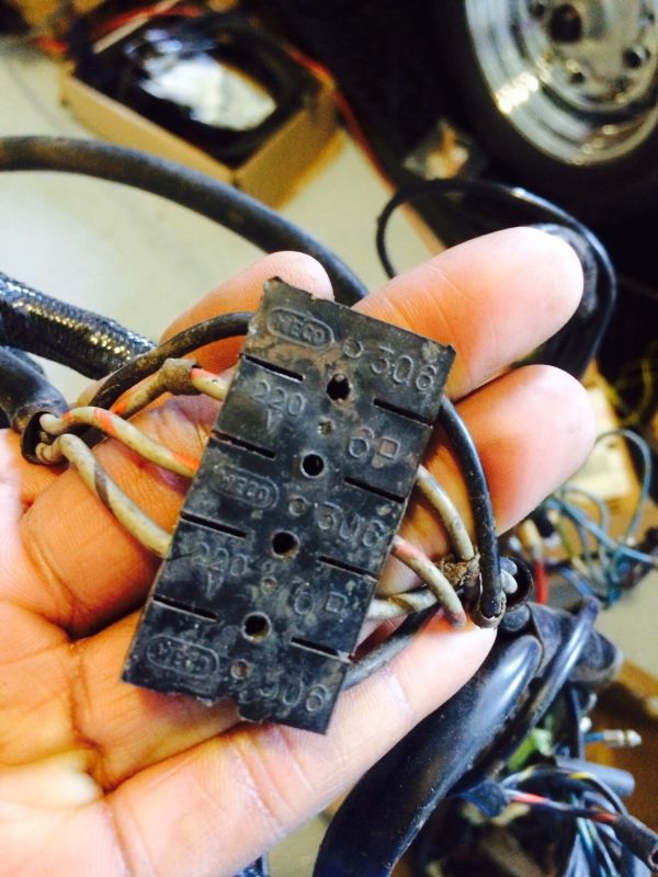

    This was not included in ynz harness.
    What is it? Need it?

    Yes. Re-use yours.
      Thanks Jack, What is that fuse block for? Must be only a B/C thing?
      Pretty car Lester!
        Yeah, the T6 has a separate loom for the dash, and forward section, and this bridges some stuff that needs to go to the rear. The blank one is for use on the 4 cam.
          Jack

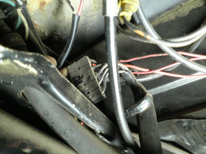

          Where would I find that on my 63 T6? May be able to take a picture for Lester.
          Phil Planck
            Phil, it is above the steering column brace, usually on the slight right hand side, opposite of the turn signal wiring. It is a connection link, with no fuses.

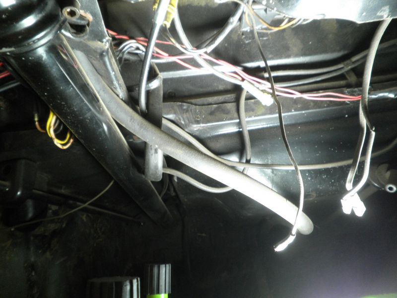

              Found it on Foam Car. Maybe these pics will help:
