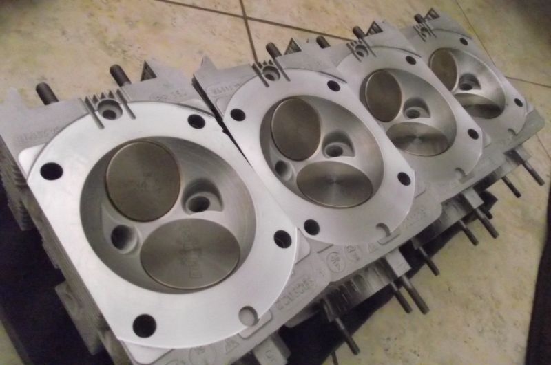

          I have nothing but good things to say about my experience with Walt at competition Engineering.
          He did an excellent job of rebuilding these set of heads for my motor.
