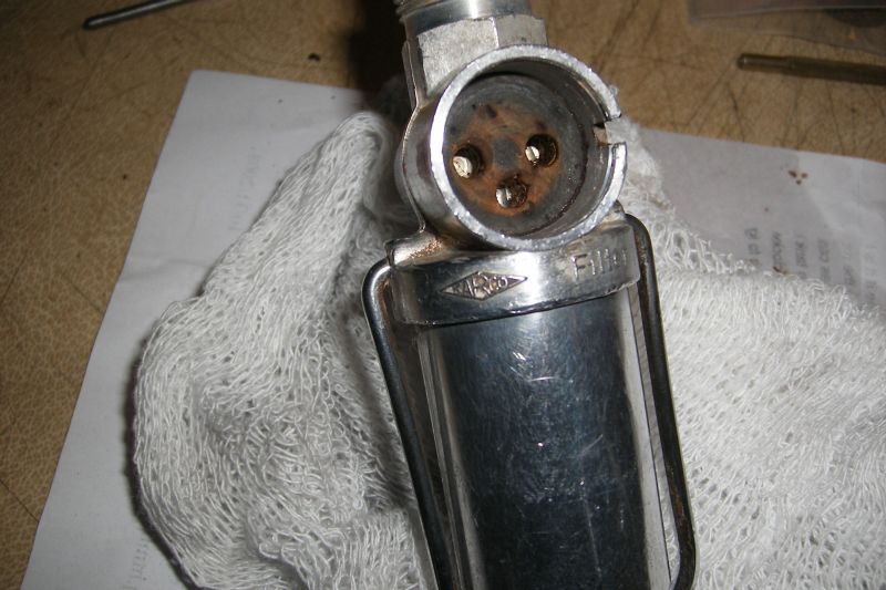

                          So many good points above. Electric pumps ah yes!!! Getting the most out of PC's even if you feel like pulling the white hair out of your head at times ah yes... And I still like cork gaskets although Norm the last one that caused the leak was not cork but some form of rubber.
                          Like you never turned off the fuel for over 35 years, never saw the need even though I had the same experience as Dick with a dodgy needle valve on a 356C.
                          Then.... One morning got in the car, drip drip drip from the petcock.Lucky I had driven it the day before all okay. So the puddle was not that much. Rebuilt the fuelcock and I attach a photo of the then 47 year old cork gasket. It resembled hard wood
                          So, that now has a similar rubber gasket as well. Maybe, the neoprene? gasket will last longer though will I still be around though in 2053 to establish that fact
