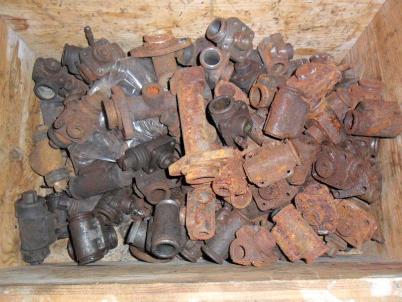

              Sorry Phil! I kept one set for myself. I`m gonna be building a 60mm set of brakes and will be using them. I`ve got about 50 lbs of old wheel cylinders and parts left.....if anyone is interested in getting into it.

                Sorry to hear about your friend Bill. He did a nice job on those GT wheel cylinders I had sent you a few years back.
