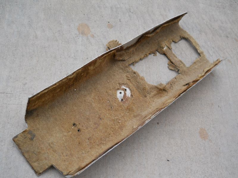

    The rubber does get glued down to the cover. The inside of that alloy cover had a pale, thin fiber/wool like lining glued to it also and probably acted as an anti-rattle buffer. Hope this helps! Justin

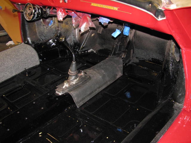

        Well guys,
        We didn't glue the tunnel rubber in the Roadster when it went togther and it lays very nicely after the rubber mats are in.
        Initially it was a little stiff but flexs in time and lays nicely.
        Not sure if the orginal was glued in or not after 45 yeas of service!
        A pic during installation.

            Gordon here is that inner insulation I was describing earlier:
