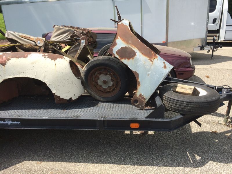

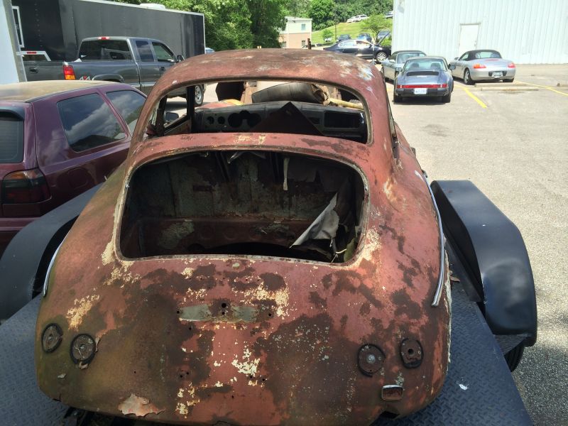

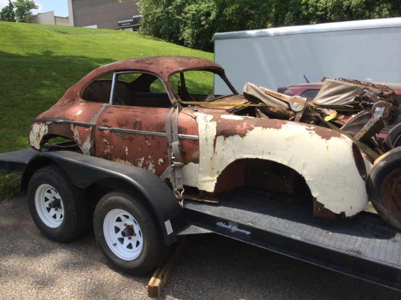

        Thanks for the info.... I'm a 911 guy that has always loved 356's and had a chance to pick these up. I wouldn't think about cutting the PRE A. My biggest concern about the cab is windshield frame being MIA. Here are a couple pictures when I say rough I mean rough....

          Congratulations Tony, those are two really cool cars. Share some pics if you feel comfortable.
          If it makes you feel any better when I bought my 57 coupe it was in three pieces

            A few pictures of the rough little cars...

                Thanks for posting these shots; glad we got you dialed in with the picture loading.
                Too bad the rear of the cab clip has been lobbed-off at the firewall(firewall would be speedster correct) that's yet another strike against using it as a speedster donor. The now missing rear inner closing panels for the engine compartment and the tail-skin could have certainly been used as they are the same for a speedster. The Pre-a looks crispy; How rusted out is it around the suspension points and the rear seat pan area? I assume the floors and longitudinals are long gone. Very cool find though! Justin
