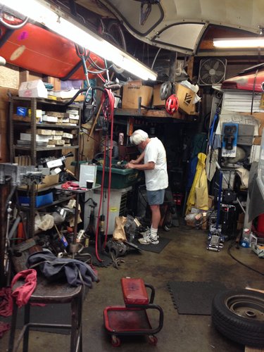

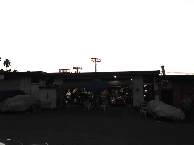

                Here's Craig with his engine on the stand at the left.
