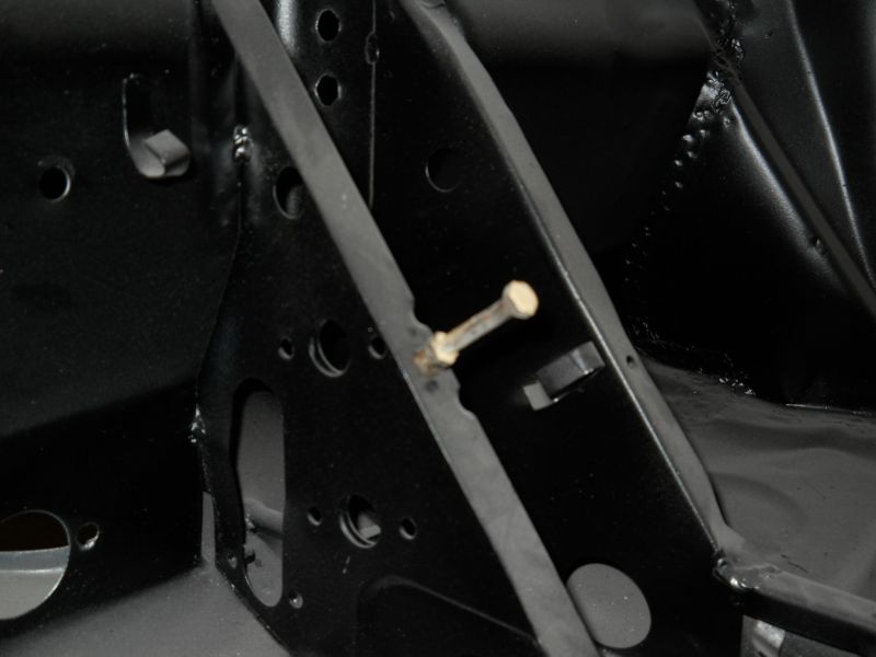

            Thanks Jack and Justin,
            My car is later than yours Justin And when Jack mentioned the throttle stop being part of the securing method on one piece boards, I am pretty sure mine are two piece boards.
            Thank you again,

            Gordon
            Here is a old picture of that area.

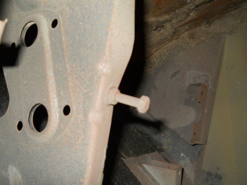

                      Gordon, Here is a detailed shot of and original with jamb nut. (10mm wrench size)

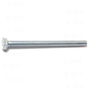

                        Original hardware is longer and threaded all the way to the hex for adjustability.

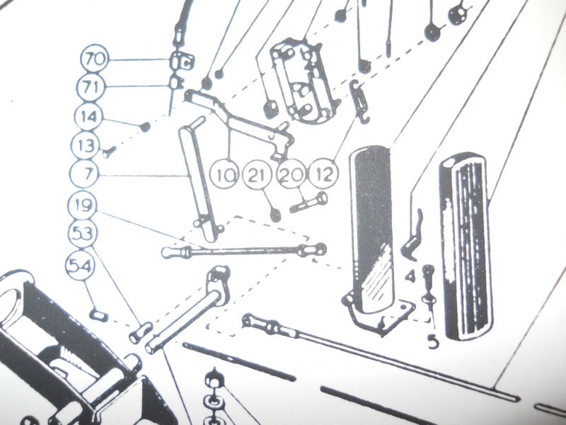

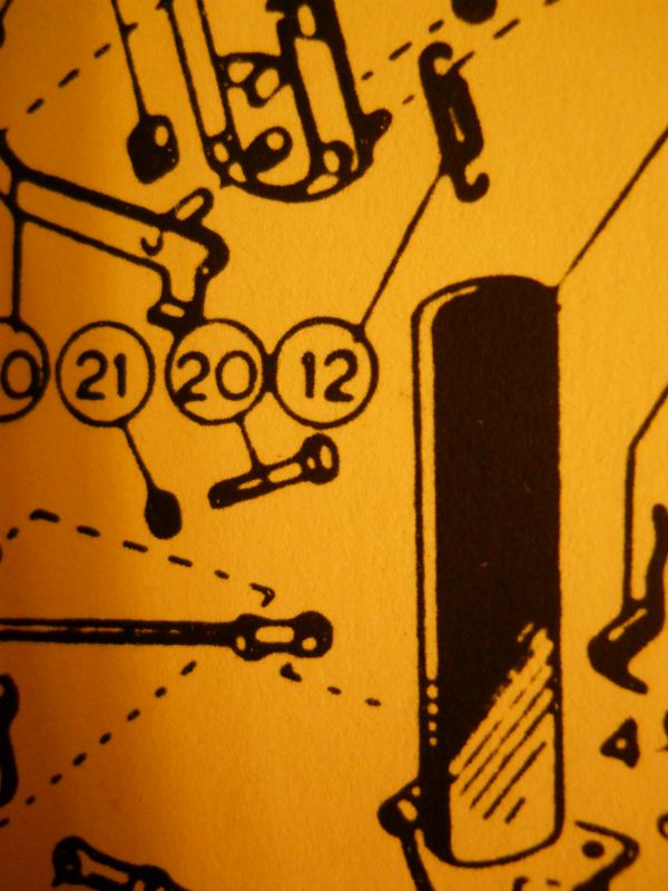

                            Thanks Jack, this is one of those interesting discussions on the fine details of 356 authenticity. I'm sure many would roll their eyes and say who cares its just a bolt but if you're into the details like I am you want things to be right when they can be. I of course consider you an authority since you've been servicing these cars almost as long as I have been alive and as we both know there are no 100% absolutes when it comes to these cars. My thoughts on this particular detail come only from my own two 356AT1 cars and what they were equipped with. You on the other hand have seen hundreds from various years so I am quite sure that a lot of them were outfitted with the bolt you describe. With this in mind I decided to consult the "good book" IE the 1957 factory parts catalog. Here is what I found, at least for 1957...
                            Part in question is item #20

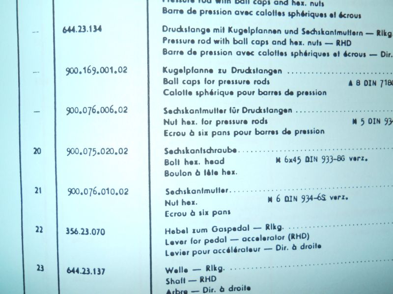

                            The illustration here does not depict an all thread shank.
                            Item description for #20 is that its 45MM in length. This means the bolt that I picked out the other night is wrong and is too long.

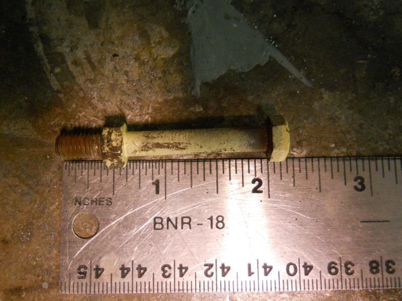

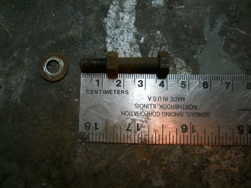

                            Here is the original in T1 coupe 57976. Its never been disturbed (until tonight) and has always been in this car. Its an original NSF bolt.
                            After removal I was surprised to find its only 40mm and is actually shorter than what the catalog calls for. This gets back that variation problem again.

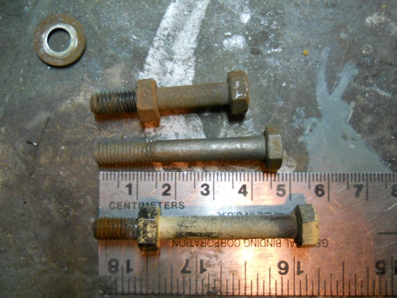

                            Top one is the original once again. the middle was one of the closest I could find to what the catalog calls for and the bottom was from a '58 coupe. Which one is right; maybe all of the above??
                            Jack, the longer all thread version pedal stop bolt you describe, was it found on that transitional super early one piece T1 toe board which also doubled as the only anchor for this panel? If so, that version would be a logical choice.
