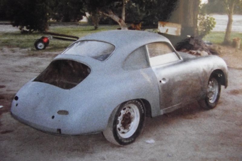

      As for my own personal experiences over the last 25 years as a hobbyist learning from my father who owned his own shop there are only two primers that I completely trust and use. For a bodywork base and lead seal epoxy I only use PPG DP40. For small parts and the like I use Dupont's enamel based "Veri-Prime" primer. Both are not cheap and the last time I bought a gallon of DP40 with catalyst it was just under 500.00 bucks. However I have been down the road of experimenting with cheaper off name epoxy's and it was hit or miss if my paint was going to be compatible with it and actually bond to it. Nothing is more frustrating as waste of time and money than using an unknown primer; Sanding it and prepping it correctly only to find later after my top color cured that I was able to Zip it right off with a razorblade. Just the same way you could zip-off a top coat of enamel or urethane from an old laquer primer. They are just not compatible.

      Here is why I trust PPG DP40. Here is my car in 1987 getting its base coat of DP. It sealed over all the old original lead and metal. BTW: While I never put bondo on bare metal anyway, a selling point about this primer was that the plastic filler actually bonded better to this primer than it did metal.

      Here is the same car some 26 years later. Most of that old primer and old body work is still there under these new tracer coats; no bubbling or lifting problems. So my main concern with any primer is: will my paint stick to it?? With these two primers I've mentioned it doesn't matter what I shoot on them, enamel, Urathane, they all bond with no issues. So I trust only them... Hope this helps! Justin
