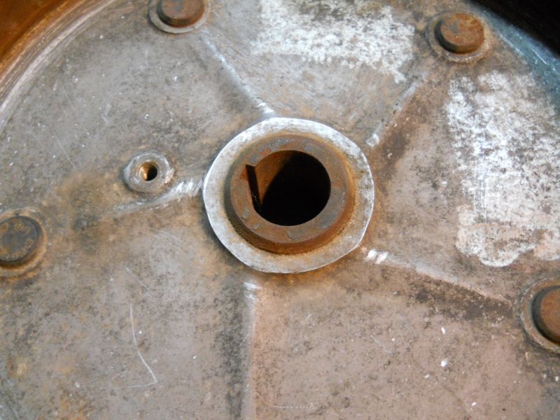

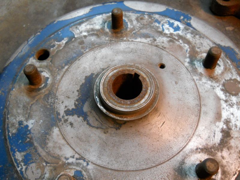

    Here is a rear drum that was "repaired" after the original splines gave way. The hole was chased clean and a single woodruff key way was machined in.
    This came on a '56 coupe my father purchased in '79. I still have the matching axle here somewhere. This had to have been done in the '60s or early 70's. It worked but I wouldn't trust it to handle any real HP.

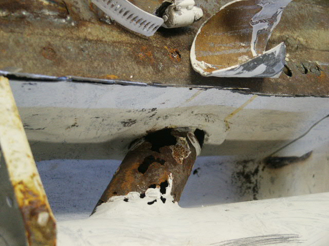

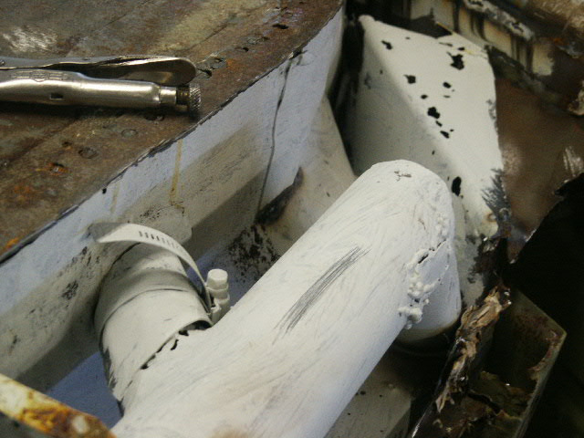

    Nice heater tube repair done by the previous owner on his old rusty speedster from Hawaii.
    Tube section here was obviously full of holes so the guy put a blanket of metal around it then secured it with that hose clamp. Didn't even cover all the holes. When I got this car this compartment was entombed under a new longitudinal closing panel horribly welded on. I guess he thought he was finished in here. The door well closing floor wasn't even repaired. Also note the scabby overlap patch at the elbow of the main tube.

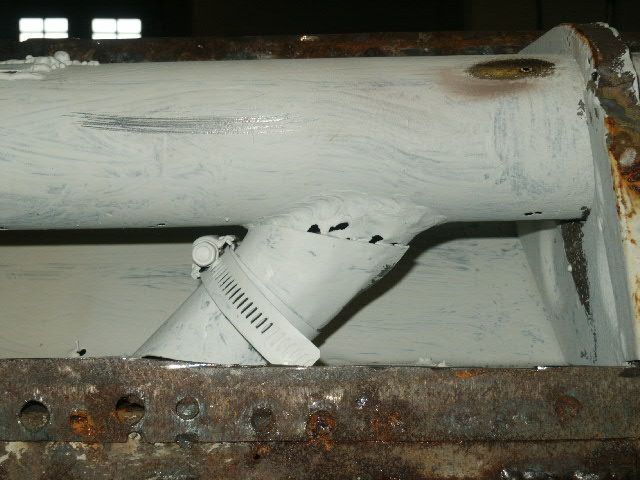

    Here is the cover removed. At least is was easy to reverse. The whole area was brushed with what appeared to be some sort of a house paint. One of those nasty repairs you just won't know about until way after the deal is complete. Please share some good ones that you may have run across. Justin

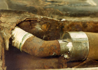

      Found in first professional job, c.1971; tuna can repair with fiberglass wrap secured with a twist-tie from Penn Fruit, a defunct supermarket chain. Hey.....it was hidden and it worked...but I made better out of real metal while fixing everything else

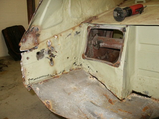

        Here are some more great examples from that old speedster:
        Original side wall was crashed and rusted out. The old owner just stitch welded a piece of metal right over it. It would have taken several cans of rocker shootz to cover this "repair".

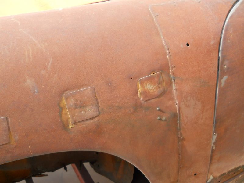

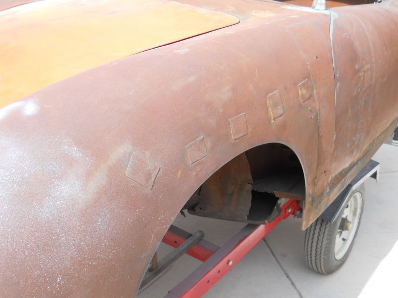

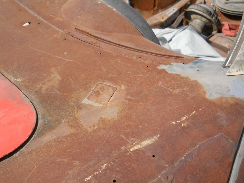

            Side spear mount hole filling on a speedster in the '70's
            Square sheet plugs brazed on then the area was beaten in to make way for the bondo. Note the crude fender repair attempt as well.
            Another hole up on the cowl treated to the same process..
