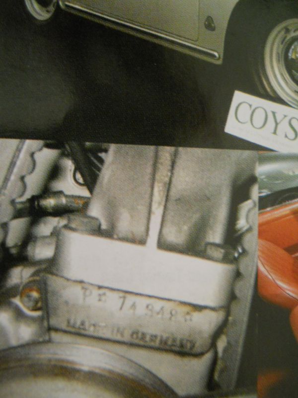

    I was thumbing through the latest Registry "market watch" and found an interesting photo. Its a convertible D that came up and is most likely being represented as "numbers matching". The case has most definitely been altered and re-stamped. Even the author stated it was "stamped weirdly.
    The "P",the star and the numbers are questionable enough the real tell tale is the lighter band of alloy directly under and to the sides of the entire stamping. Its clearly been TIG welded, dressed down and re-stamped. This lighter band is caused from the alloy composition in the rod that was used not being exactly the same as the alloy that makes up the case. A lot of shady practices going on these days....
    Justin, I respectfully disagree with your wording and would like to suggest changing "even" to "especially."
    I have seen a lot of sloppy engine stamping, I guess done by an apprentice or the mechanic being under time pressure, but never seen a mix-n-match font size. The Teutonic style is more vertical, the top of the '4' is usually open, the '8' is usually a stacked oval, not circles, etc. That numbering looks as if it was done 'in situ.' A shame that such weight is put on "numbers matching" that such attempts as you illustrate are seen, just in an attempt to gain added value. That's not a new wrinkle, either. Been going on for decades.
      Very true Bruce; I changed the title. Thanks! You high lighted several more short comings with the characters than I saw. This alteration could really cause problems for the owner if a sharp police officer ever saw that... Justin
