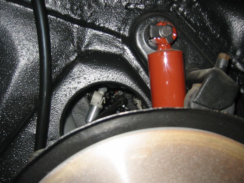

    Driving around checking ride height I am finding the lower limiting factor is the right ti rod hitting the fuel line / outlet at the fuel cock.
    The ride height attitude in the picture below has the ti rod rubbing to the point that it would rub thu the fuel line and or damage the fuel cock.
    Actually I would prefer to run the car closer to level (less nose down) and i have raised the front since this photo - eliminating the problem.
    Now that I have a more level attitude I would like to lower the whole car a little.
    I can raise the fuel tank a little (it might be slightly lower than when it left the factory). I could rotate the steering box around the torsion bar tube a little (modifying the dowel pin hole). Or I could bend the steering arms down a little.
    My point is, with some of the C cars i see lowered in pictures, I am wondering how close the ti rod is to the fuel cock outlet. I am not talking about drop spindles here. I am referencing all stock parts.
    Anyone ever look at this? To check the clearance I removed the steering box inspection cover in the trunk and used a mirror and flashlight.
    The wheels and tires shown on the car are some junk ones for rolling the car around but they 15" wheels.
