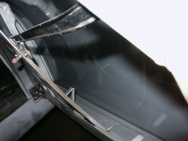

      I realize you were asking Bruce but here is what I did on my old coupe doors:
      The insides were cleaned of all old rust (muriatic acid bath) thoroughly rinsed and neutralized, epoxy primered and painted like I would the exterior. Crevis was packed deep with axle grease as an added inhibitor. Excess cleaned and sealed over smooth with clear silcone.( I am rethinking the silicone BTW; if there is a breach and water gets between its a perfect incubator. Its better to leave open so the air can evaporate it. So I will be removing it most likely) Just before the door panel goes on for good the entire floor will be skim coated in grease. As I said in my build thread I would much rather have a nasty, gooey mess down there than to find rust bubbles forming under my paint again. My last bit of prevention will be keeping as much water from getting in there as possible in the future. Example when it gets washed a piece of plastic will be draped over the door frames to shield the gap at the base of the door glass. As Bruce stated just like a speedster door is shielded and capped from direct water entering.
        Justin,
        The inside of your doors are show quality!!

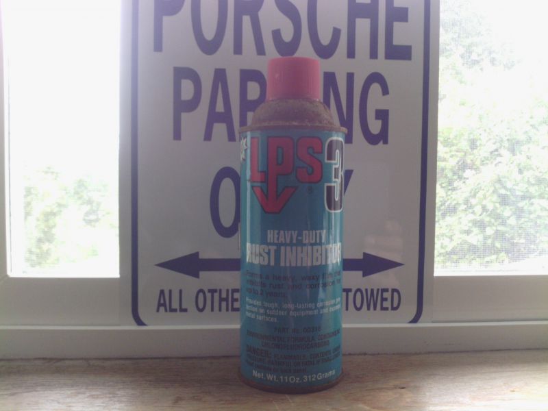

              This works well at the bog &at the beach.
                Thanks Steven, I look this product up on line.
