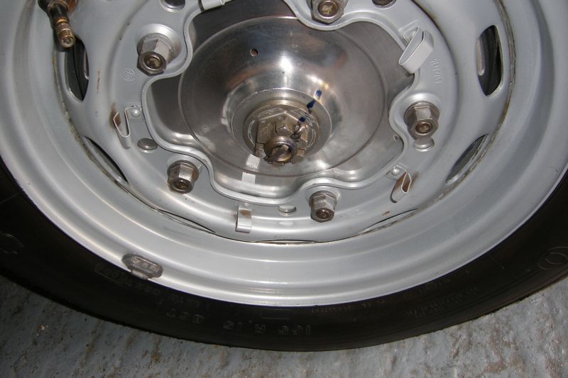

          When I had replaced the rear wheel brake cylinders with new ones a four years ago I was careful to mark with 'blue marker' the exact position of the nut and split pin in relation to washer. I wanted to repeat exactly the torque applied back in time.

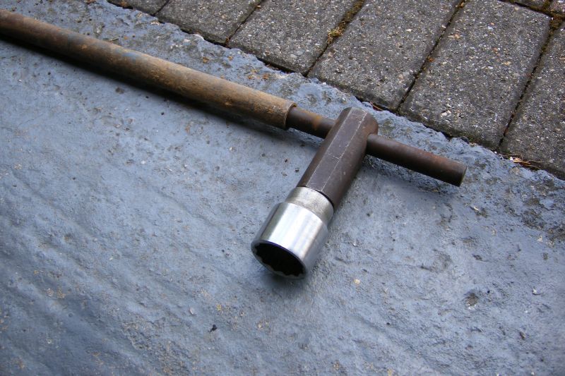

          I have my own 3/4 inch socket and breaker bar a nice pole for the lever. After doing the brakes and tightening the nut using my weight and the length down the pole it corresponded easily to the original split pin position on the shaft. I could have gone the extra foot pounds but refrained from doing so. The result since then now seems to work well but of course I do not apply great cornering forces to the car as you might if it were raced.

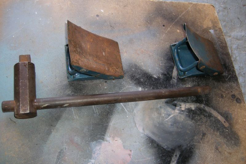

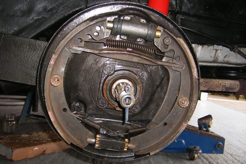

          Attached a few pics of my home made tools

              You shoot a good illustration foto, Mr.Mawbey.

                An afternoon in the garden having lunch sounds like a great day Roy! Thanks for the great photos and details. I like your tools BTW! My theory on the torque values being raised through the years was perhaps from real world driving feedback showing prematurely worn splines? Just a theory of course.
