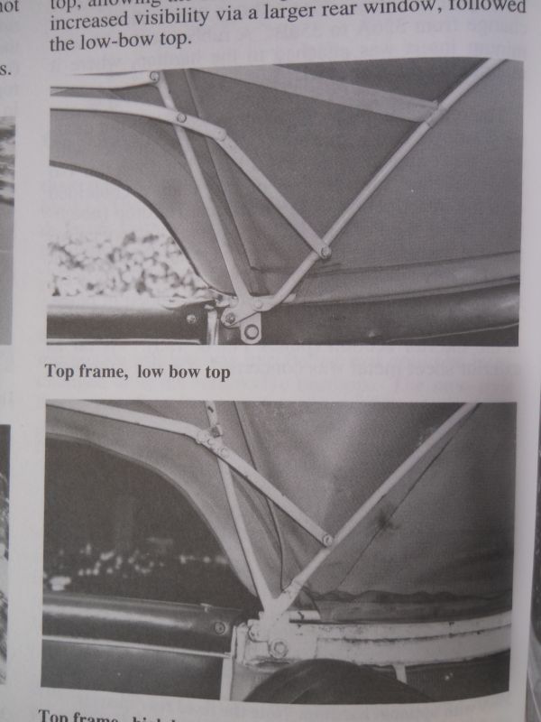

    This photo is taken directly out of Brett Johnsons Porsche authenticity book. He was right on the money in describing the top frames. I learned this lesson the hardway after 8 disappointing purchases of this second gen. frame all claiming to be low bow frames from a pre-a or an early 356A. Once we measured them they ALL came out about the same. I learned Once the linkage configuration changed it became a "high bow" frame. There were some evolutionary changes; small back window(pre-A&AT1)to big back window(T2) but the center bow was raised up when this second configuration came out.(= "higher bow") Again this happened in early 1955.

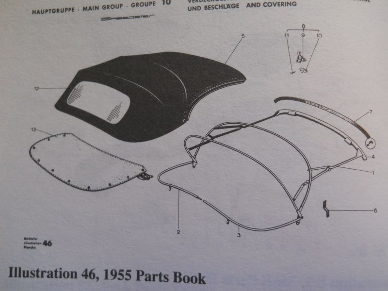

    Here was the second bit of confirmation also taken from Brett Johnsons book. This is an illustration taken directly from the 1955 parts catalog. It clearly depicts the second generation speedster top frame version. The original "low bow" frame was gone quite early.
    A more recent discovery closely pin pointing the low bow's exit from production is 1955 speedster chassis 80469. It is pictured above and retains its factory original "high bow" version top frame. So by at least the 269th '55 speedster the factory was no longer installing the low bow. More later. Thanks for reading this! Justin

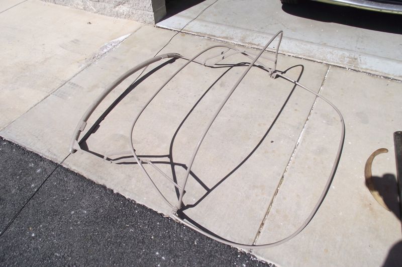

        Speedster top frame spotters guide.
        When I first began this journey for a low bow top I was hard pressed to recognize these subtle differences in the two basic frames. Now however I can pick one off at a glance. Here's what to look for:
        Here is a direct side by side comparison of the two frames. The 1st generation lowbow top is on the bottom (tan repaint)and the second and final frame configuration high bow is on the top.

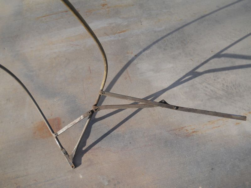

        To the untrained eye they are dangerously close and quite similar. The first obvious change was to the rivets. Early lowbows used a solid steel rivet and the later second version frames went to a hallow brass rivet. Infact on closer inspection these "brass rivets" were not really rivets to begin with but are just sections of brass tubing that were flare punched at both ends.
        The second subtle difference is to the configuration of this foward connective linkage. Note how the lowbows upper link swoops over the main center joint and "leapfrogs" over creating the "lock" or stop for the frame. The high bow by contrast is just a straight shot and configures more of a strong "V" shape. The little "Half-moon" at the bottom of the center joint beacme the new "lock" or stop for the high bow.
        Here is a detailed shot of the new Lock/stop for the high bow. This "tooth" became my first tell tale sign when I was figuring all this out. "if it has this feature, its a high bow". More details ups next. Thanks for reading this! Justin

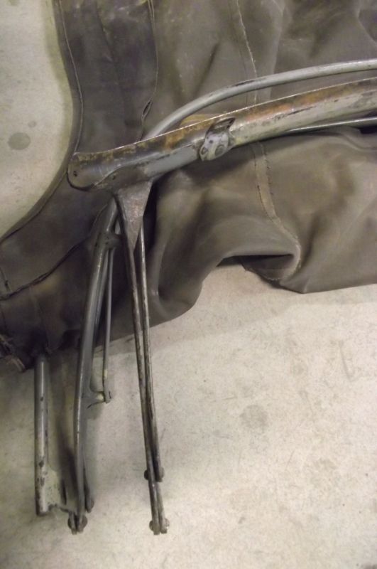

          One of that last and most easy difference to indentify between this two frames is at the rear bow's lower mount.
          A first gen. low bow will have this dog leg kick at the end of the rear bow. The fulcrum tab it works off of is pitched at a lower angle.
          By contrast the second version's rear bow has no kick at the bottom and its fulcrum tab is set at a much steeper angle to probably eliminate the need for the previous bend to the tips. The tab is also a bit longer than a lowbows tab.

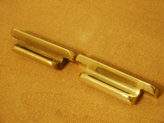

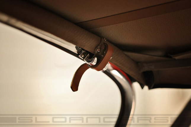

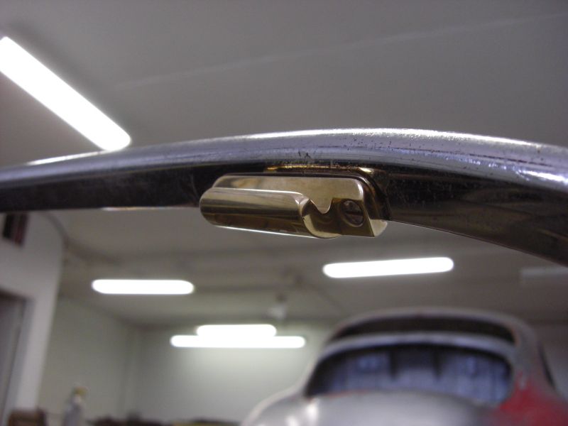

                        My next mission was to make this early unique latch assembly complete and functional again. To do this I would need the leather strap dimensions and the other half of this latch; the female reciever which mounts onto the windshield frame. A very tall order to locate a pair of those being only about 44 pairs were made.
                        I had this photo of one from my old excellence magazine from '88 when they did a story on Speedster #5. However there was no way I could have an accurate copy made from just this photo. I knew I'd have to find an original to copy from.
                          After some asking around it was my good friend the late Ed Smith in Eukia Ca. that came through for me. During this time he was restoring speedster #14 and graciously offered to help by sending me one of the original recievers from this car to make a pair of copies from. Will always be grateful to him; Rest in peace my friend. Here are some comparison shots:

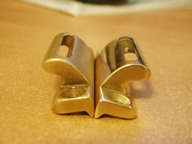

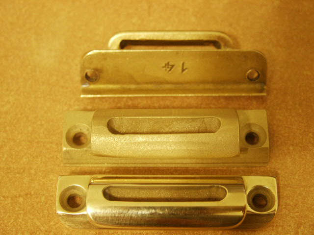

                          Original #14 on top and a new copy below.

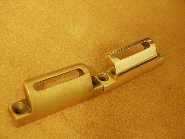

                          Original on top again, middle one is how I picked them up in very basic rough form from the machine shop. I spent several hours carefully filing and shaping to get all the contours and corners correct. Then more time still hand sanding the file marks out and finally polishing the brass. Bottom one is in finished form and ready for chrome plate.
                          Having an original example to directly copy from was so crucial. The approach angle of the reciever slot had to be right on in relation to its base and its ultimate mount attitude once on the Windshield frame. Original one is on the left.
                          Original on the left. I was pleased. Though It was 600.00 in machine shop time this was my only shot, I had no choice.
                          I now had the other half to make these latches work again.

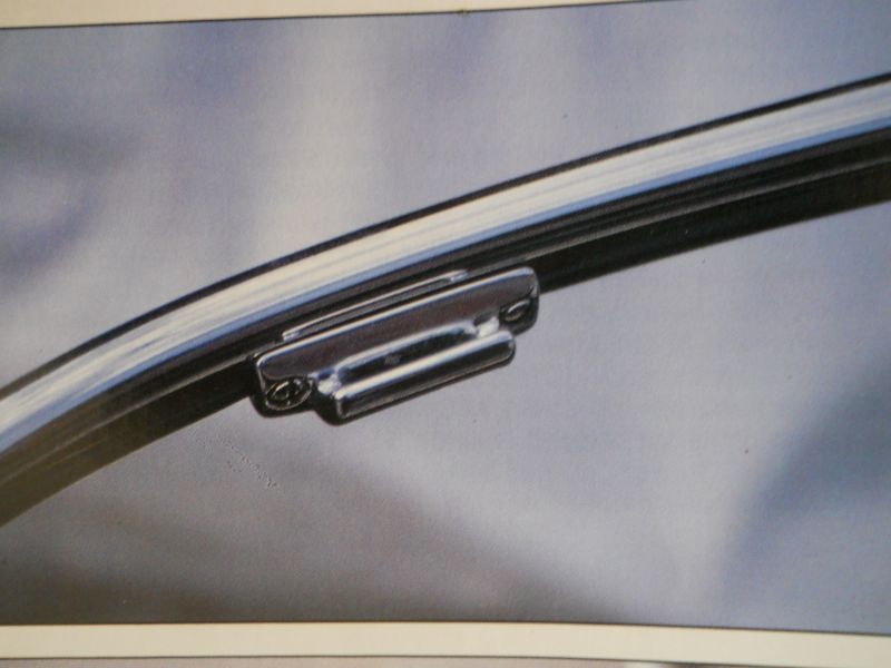

                            Now for the fun and exciting part of mounting them to see how it was all going to fit together. Fortunately the speedster windshield frame remained unchanged all through its production run so it was only a matter of tapping a couple of new holes into my WS. frame.

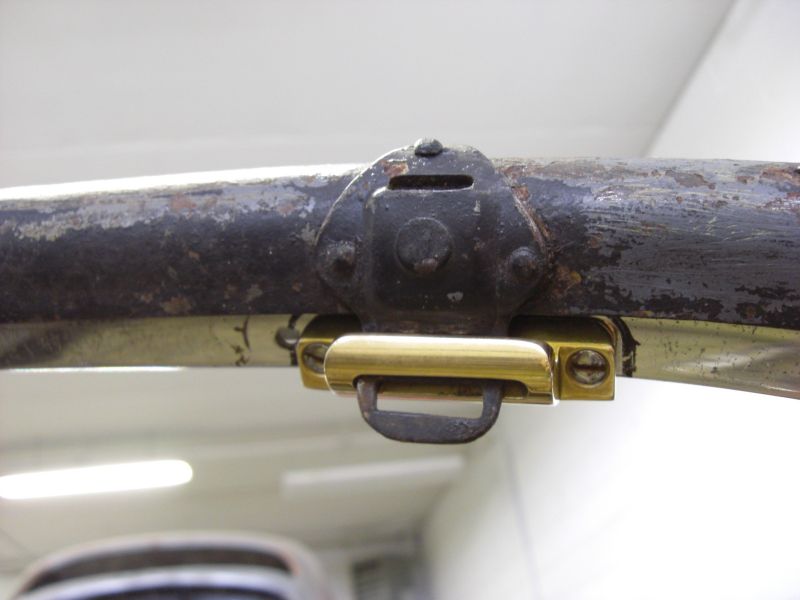

                            Pictured here fully mounted with correct chrome spade screw. I found that coupe rear quarter hinge screws were the perfect length and head size.
                            They fit like a glove. The lip on the mounting face hooked right under the edge of the Windshield frame just like it was supposed to.
                            Now with the top frame for a test fit. Could not have been better The approach angle on the reciever hole was right on and everything slipped into place. This was a great day!

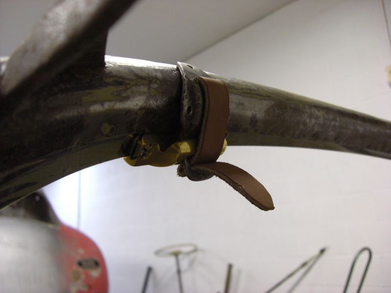

                            I quickly mocked it up with a strap from some leather I had laying around. I now needed to find out the exact dimensions of the original and how it was actually used. Another email to Don Zingg was in order. Up next. Thanks for stopping by! Justin
                              Contacted Don Zingg about the leather strap details here was his response:
                              Hi Justin,
                              Yup, all is well here - - hope that's the same story at your end.
                              The original "top latch" straps were 14mm wide, not more than 2mm thick, and approx.* 170-200mm in length. In all my travels I have yet to find an INTACT original strap, and so the length measurement is a guesstimation. The strap must be long enough* to manipulate into the tab slot, roll it over and back up thru the tab slot - - but not too long as to hang down into the driver's field of vision (that's a laugh!).
                              The thickness of the original leather strap is reminiscent of the thin leather used on the OEM luggage straps for the early 356A cars.
                              Hope that helps.
                              Don

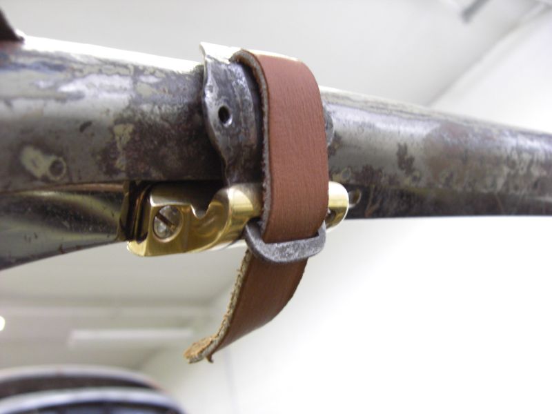

                              Approximately 200mm in length? At first I thought that was way too long; and it certainly would hang down in the field of vision especially the way I had it just lopped through once! However once I figured out his "double back" sinch it made perfect sense.

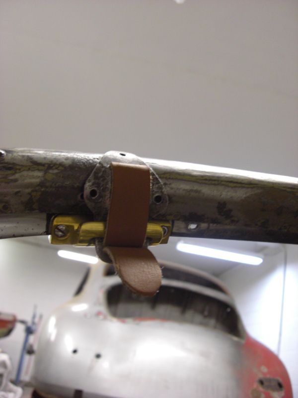

                              Even though I never saw this latch engaged before this mock up just did not seem correct and it certainly wasn't secure just passing through the eye under no tension.
                              After I got my head around Don's description I cut a new leather strap, this time longer. Pulled the leather back through and it sinched down just like it was supposed to.
                              This is how the design works and made perfect sense at that moment. My thanks again to Don Zingg for sharing his knowledge with me! I may of just left it hanging loose incorrectly like these guys:
                              I got in contact with Tony Singer next to have him make me up some straps based on Don's dimensions. Up next. Thanks for reading this! Justin
