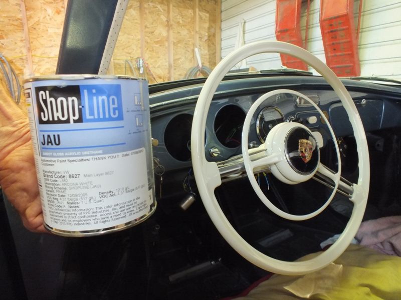

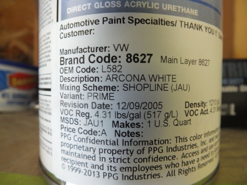

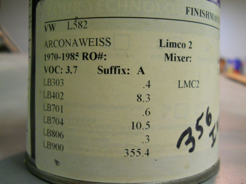

    The direct match for Porsche 356 Ivory as passed along to me a few years ago by the late 356 restorer Craig Stevenson is VW Arcona White. I was in the middle of a steering wheel restoration for Bob Dicorpo's speedster in which he wanted the correct shade of Porsche 356 Ivory. Below are some detailed shots of the label with mixing code. I hope this info may be of use to someone in the future. Justin

    VW Arcona White = 356 Ivory

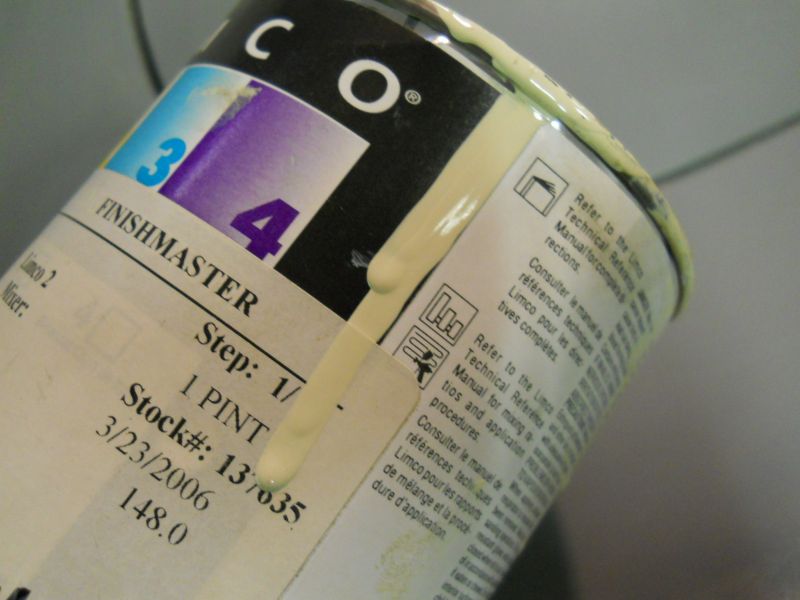

    As you can see there is lots of yellow in it, However once it was shot on it was a very interesting and pretty shade.
    Thanks Justin, Arcona white in a ppt formula single stage urethane was a good call.
    Gordon
