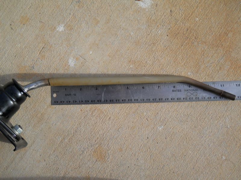

    Hey Gordon, Maybe Mark can get to his quicker than I can mine but If not I can dig mine out of the storage box and get some measurements and detailed photos for you...

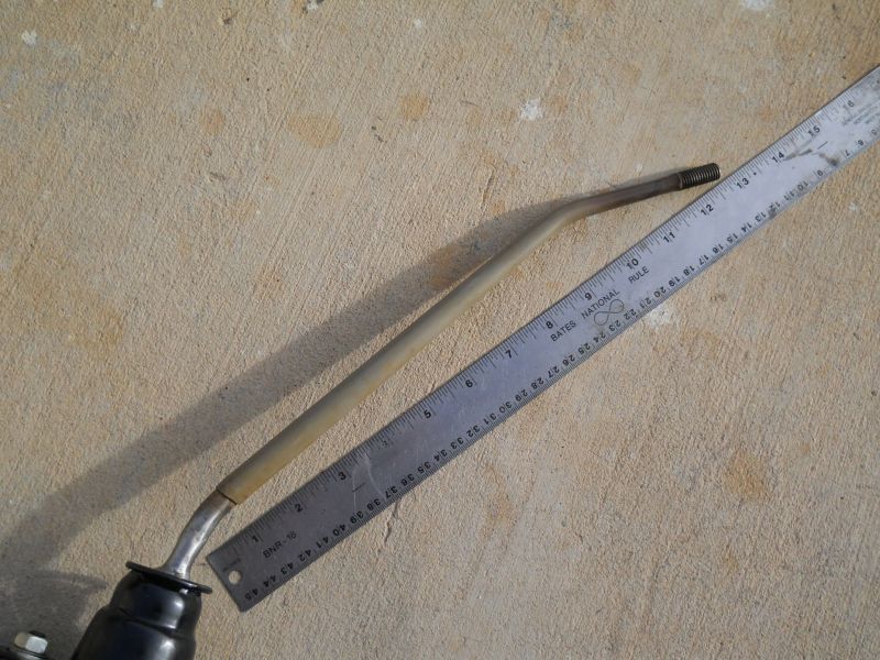

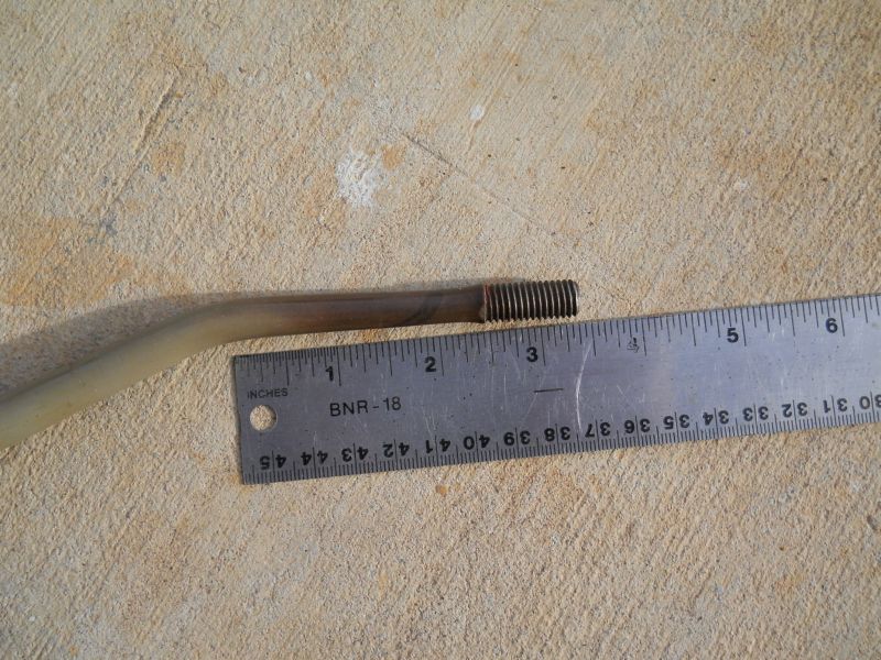

      Hey Gordon I hope these pictures will help. The stalk is just better than 13 inches long. (few MM longer) This is measuring form the top of the ball socket to the threaded end and also taking the two bends into account. Here are some shots. Justin

      To give you an idea of the distance between the two bends.

      After this bend the shaft tapers a bit before the threads.

        Justin, Your a life saver that's just what I needed.
        Thank you very much, Gordon
          Sure Gordon anytime! Just let me know if you need more detials and let us know how it goes. Justin
