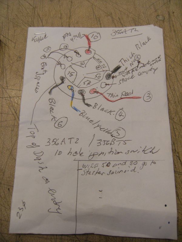

    Now....it was strange I read an old mail on the internet about fitting the switch and installing the 6 wires. They spoke about a special washer with tabs that will hold the switch in place on the dash as you tighten the chrome domed nut with the holes on the circumference. I used a converted spring caliper to undo this nut and never saw this special washer on retraction? The large nut was there so until I saw a photo this week of Justin's 356 Carrera dash panel it would have stayed that way. But.. his ignition switch hole has 2 slots stamped in it 180 degree apart. Now .. my RHD dash only has a plain hole stamped! I went to the garage and felt up behind the dash and low and behold the special washer had fallen into the groove at the bottom of the dash. The tabs were pressed flat!It had fallen off as I retracted it. Were the slots forgotten on RHD 356A dash panels I wonder??
    I thank Justin for his photo as I was so confused on that washer and I hope my bullets will fit the new switch when it arrives.

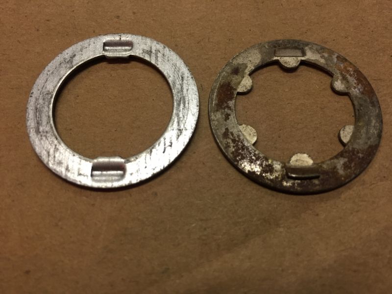

      Addendumb: I meant to post the differences in the orientation plates for the ignition switches.
      One the left is the weak aftermarket ring. The dents (2) are to work with the switch and the dash hole slots to deter the whole unit from turning when the key is rotated. The original on the right allows a variable orientation and there are much more pronounced detents (2) for the dash slots. Yes, Roy...I believe your dash is the anomaly. Even being RHD is an anomaly to me!

          The special washer is identical to the rusty one you showed on the right of your post Bruce. I will file some entry slots for the tangs.

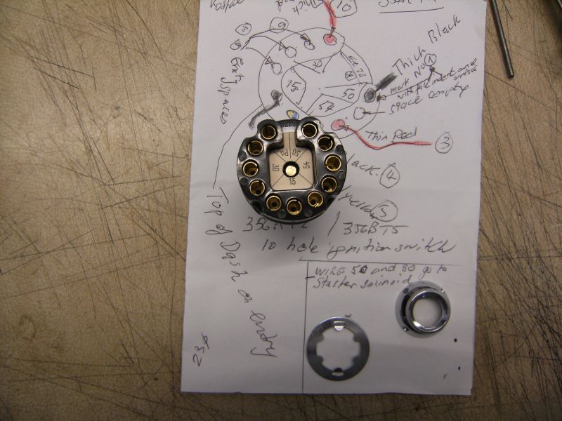

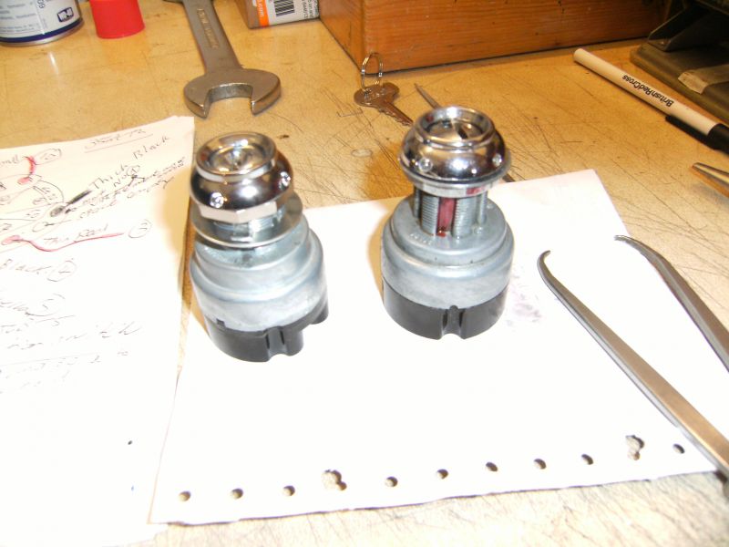

                      Here is an view of the Stoddard switch alongside my 60 year old original. The A-T2 switch had 10 connections the new one eleven thats the only difference. I used the switch marked connection holes and the original bullet ends fitted perfectly.
                      You are lucky to have some good lock repair guys in the US. Second photo shows the 11 hole new version with Pa hole not used.
                      The first photo shows the new item on the left old on the right.

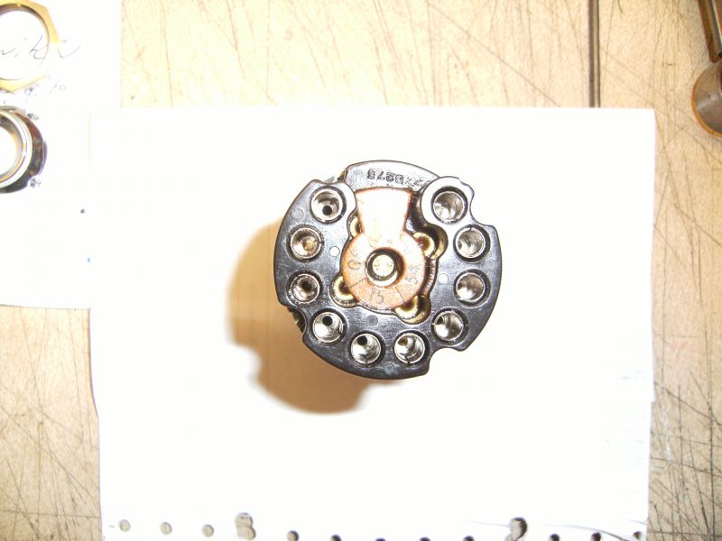

                      Third photo shows the new 11 hole switch with Pa not used

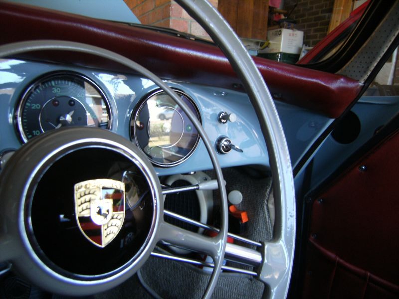

                        Should have included a shot of the new switch after fitting it to my car. Looks original !
