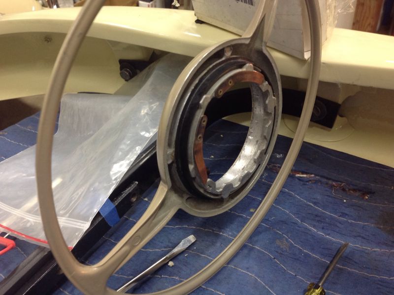

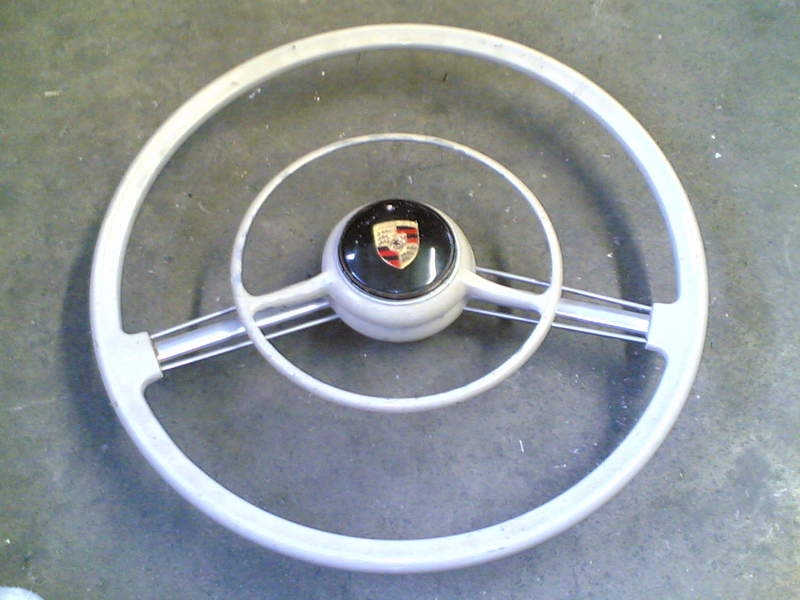

    I recently bought a Porsche 356A steering wheel with horn ring (see also pictures).

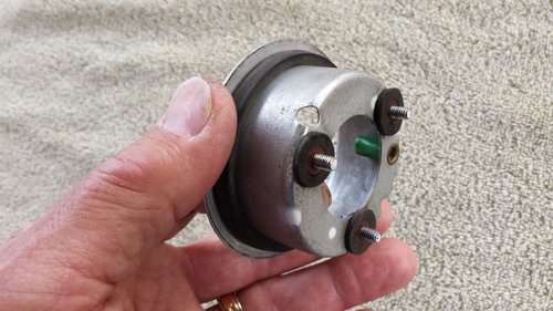

    I also have the metal cup with the rubbers and bolts

    But I have problems with installing the horn ring onto the steering wheel.
    When I mount the inner metal cup (with 3 bolts) onto the steering wheel; the horn ring gets fixed onto the steering wheel.
    No possibility to push onto the horn ring
    Can anyone help me?

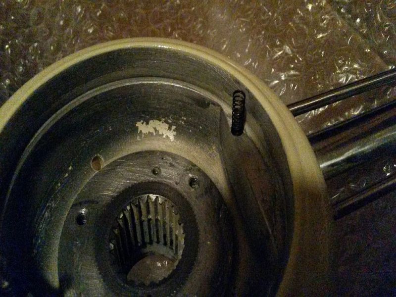

        I also added 2 small springs on the pins (the pins that prevent rotating the horn ring). this gave the horn ring even a more stable behavior
