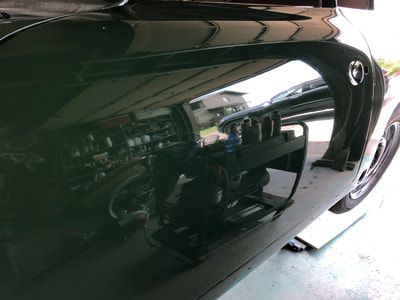

its Irish green.
I forgot we documented these https://forum.abcgt.com/forum/main-f...ct?view=thread
But but look at the shine.
This is green, but the light source is to show the smooth shine.

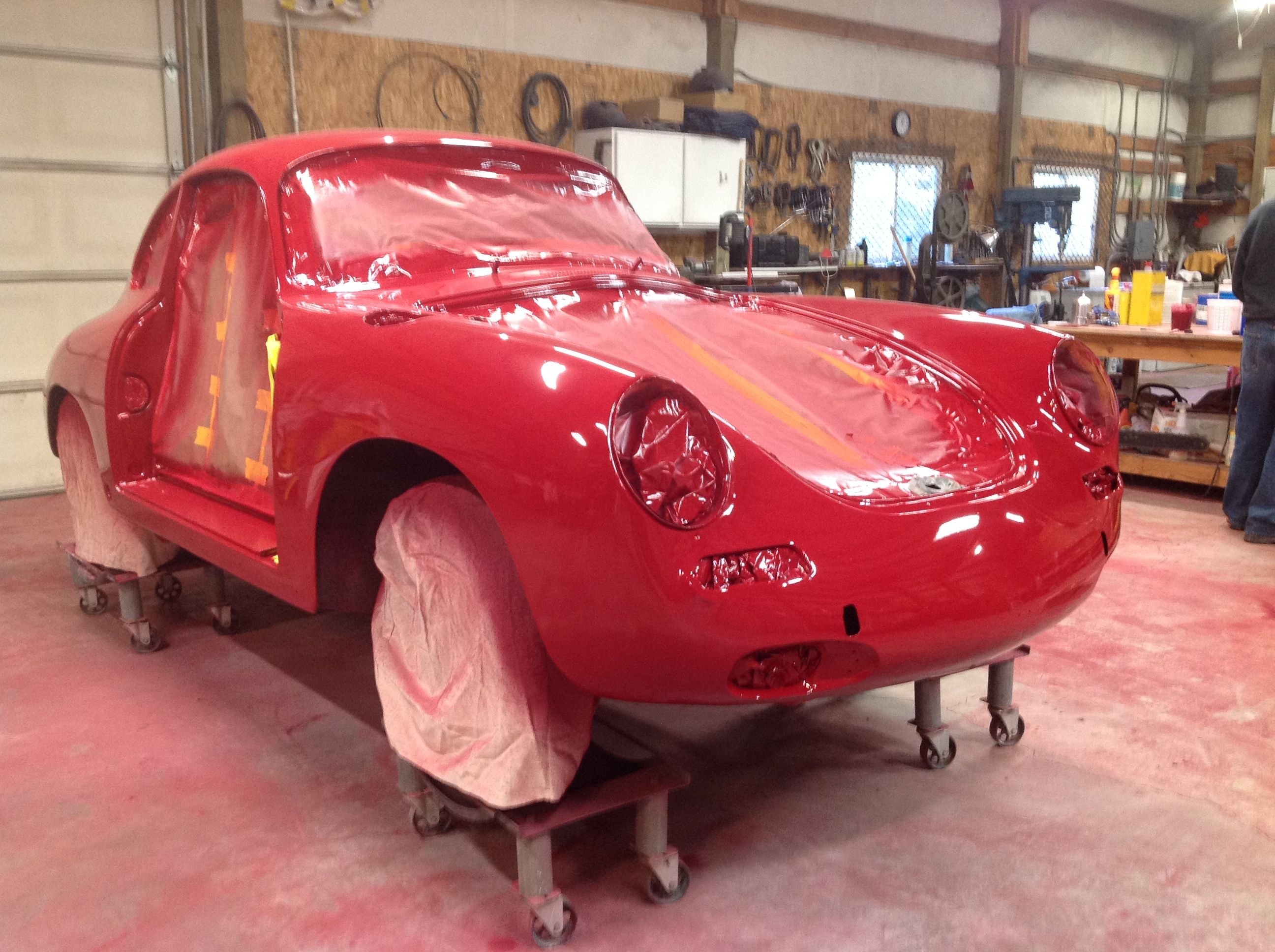

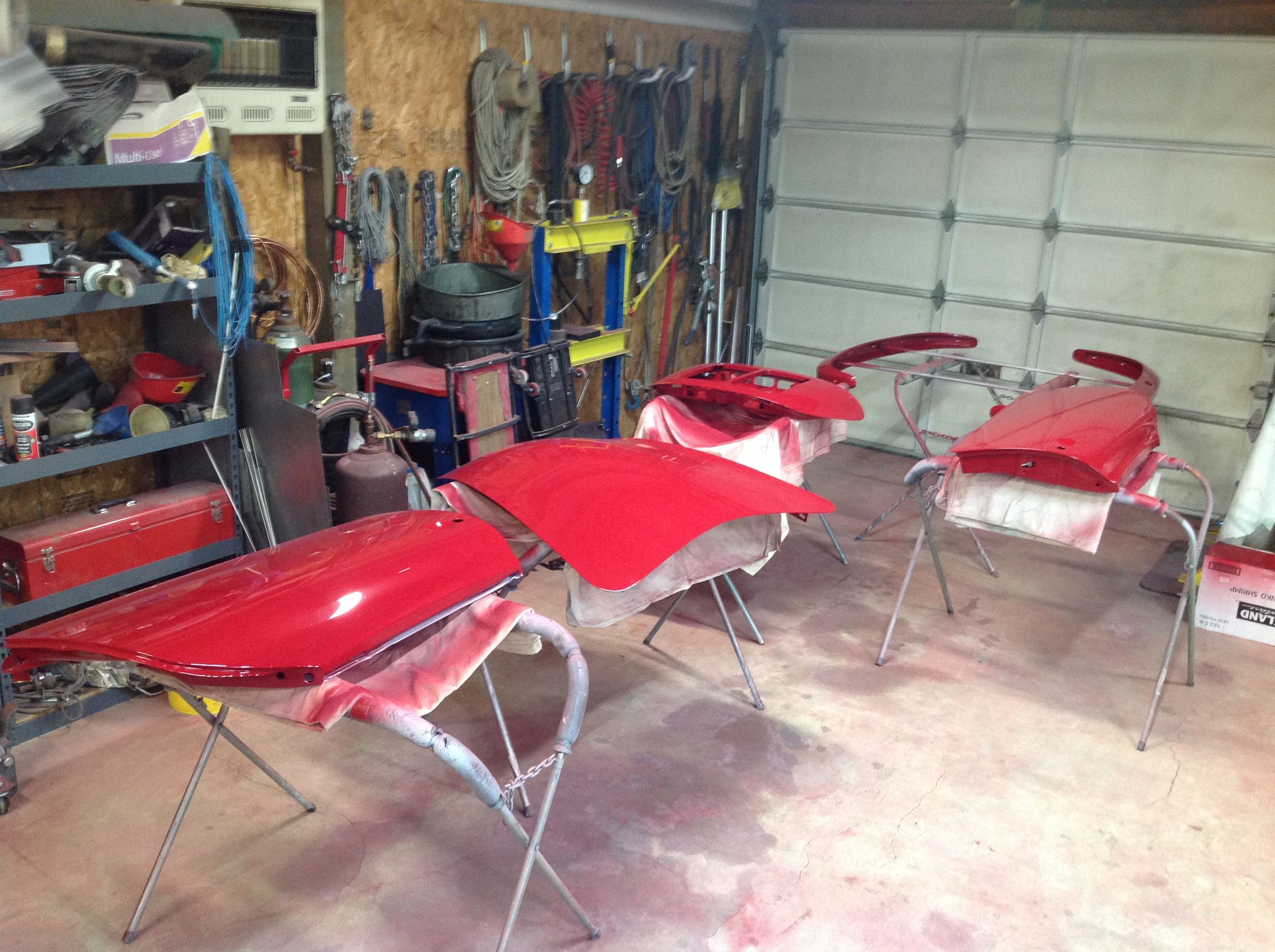

Rubt Red Same process gallon of paint.
