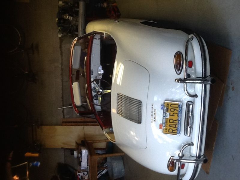

    I have an aftermarket cabriolet top frame that I want to pre-fit to my 59 T2 cab. I had to repair several issues that were present from the mfg. these come delete the front wood bow which has to be hand-fit to the car. Hoping someone can point me towards a tutorial or any written article that can explains the details involved. I will not be covering the frame ( canvas/ headliner) but want to get the frame with all hardware and front bow in place and fitted to my car before having it professionally covered.
    Thanks in advance Max H

    I don't know of any specific articles Max but I do remember there being a problem with the way the approach angle was milled into all the early wooden header bows from Stoddard. I watched two original top frames being fitted with them and once mounted they never seated correctly on the car. The bows all have to be filed and altered to work correctly. That was several years ago so I don't know if that was ever corrected but that is something to watch out for. The fact that you're also using a repro frame complicates it further I would think. You'll have no choice but to build it on the car.
        Thanks jack & Justin , Great advice. I'll be sending the bows and Cab. To Autobahn Interiors. Tony knows the ropes and it will be done correctly. Sometimes it pays to defer to the experts.
          Oh. I mistakenly understood that you would be fitting the bows. My bad. Sorry, and never mind.
