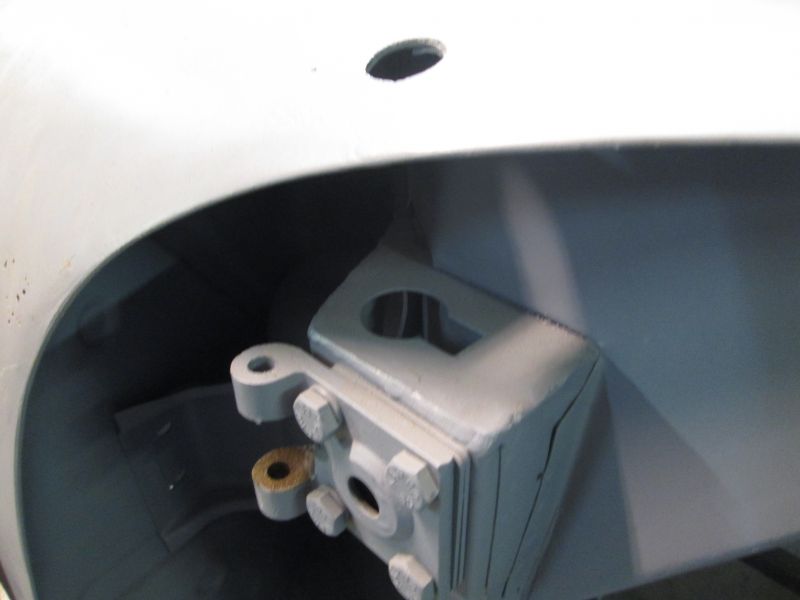

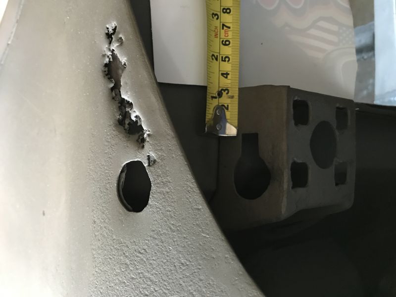

    Hello
    Does anyone have a picture with dimensions where to drill the hole in the body for a hirschmann antenna on a porsche 356A?
    Grts
    Bart
    Hi Bart,
    Sorry for the late response just saw this today.
    Here's a factory install on a '59 coupe.
    The rule of thumb here is just to make the hole in your fender is as close to center with that relief opening for the antenna in the upper hinge boss directly below.
    Hope this helped.

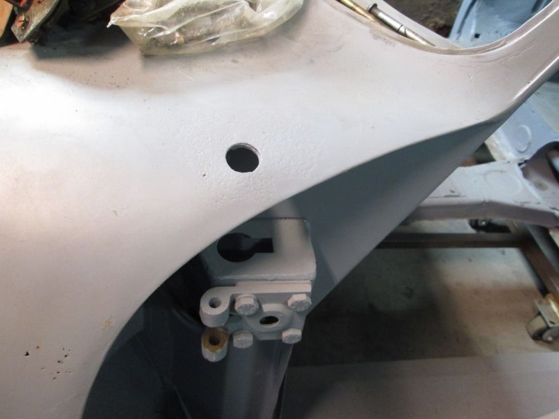

      Hi Justin
      Thanks for the reply and pictures
        From my 57 Coupe
