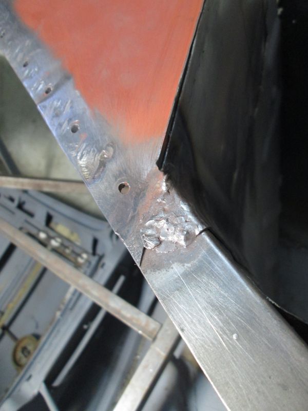

    We are in the process of a 356a T1 restoration and I'm looking for some details from known original cars. First, I'm looking for weld details on the rocker panel supports. Thanks in advance, Tinman
    Forward section gets a small seam weld to secure it. Rear bracket would have been spot welded at both ends.
      Justin, thanks for your help. The forward section doesn't get the small rectangular piece of sheet metal like on an NOS rocker?
        No worries. Almost all of those NOS rockers that have come up for sale or that I have seen where for a B or C car. That small rectangular piece is a later model detail. 356A'a just received a small gas welded tack directly to the splash pan flange like you show it.
          one more weld detail question. hopefully the last one on the bottom side of this car! I'm looking for weather or not this seam at the front of the longitudinals should be welded or left alone. Thanks in advance, Tinman

            End of the longitudinal gets a little gas weld.
