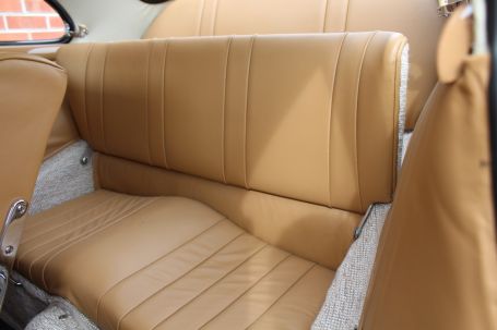

    I am looking for some information to help clarify some details relating to an original 1956 356 coupe interior. I think one item at a time may be the best way to move forward.
    We have a customers car that is being restored 100% original (excluding colour combination) and some interior details are a little unclear. After extensive research of other comparable cars I feel there are some gaps and possible errors with their restorations so that they prove not to be a reliable source of authenticity.
    The first item that I would like to clarify is the relationship between the verticle seams in the upper part of the rear seat and the seams on the rear firewall panel trim directly behind it. also the position of the luggage tie down brackets on the rear fire wall panel trim.
    I have seen so many 56 coupes done just a little differently but would like to confirm with an original car or a car that has been trimmed as per original. Unfortunately the car we are doing has been re upholstered at least a couple of times and the original trims are long gone.
    I appreciate any feedback or direction and look forward to being able to sleep at night as these little details keep me sleep deprieved

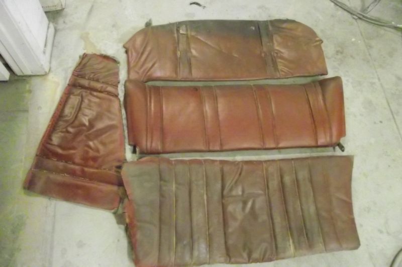

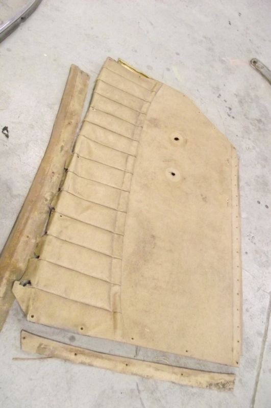

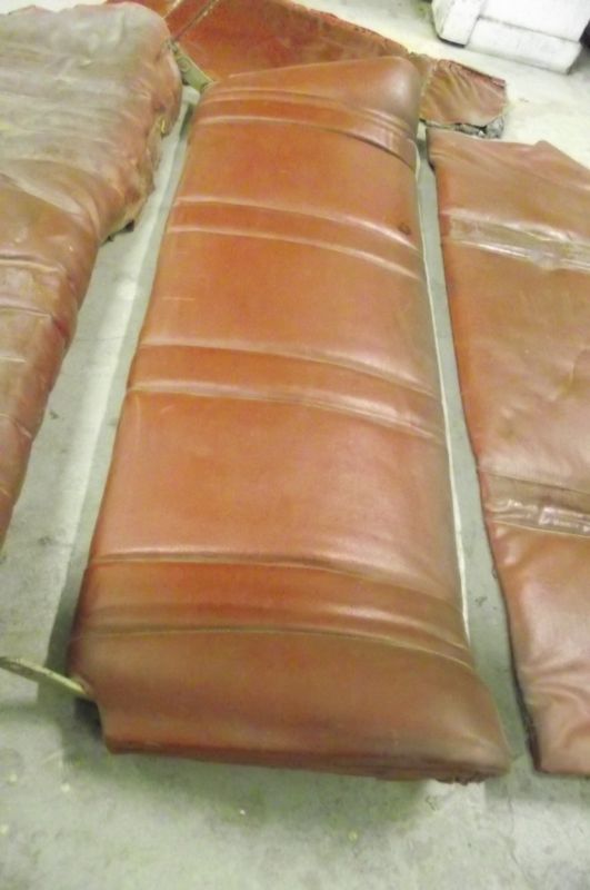

    These are the original rear panels from my '56 coupe project # 57976
    I have since sold these to Road Schollars for patterns but I did take detailed notes and photos for my own future purposes. Just tell me what you need. BTW: I still have an original jumpseat for my car still in its factory hyde if you need measurements.

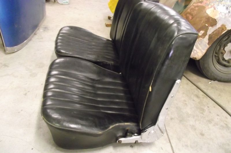

    I also have T1 seats still in factory covering as well.

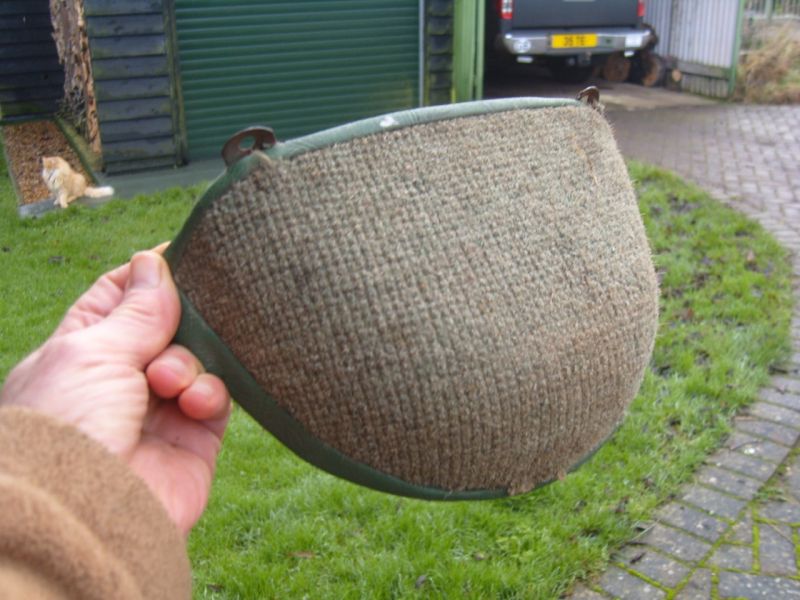

      I acquired this gear cover the other day.
      Most re worked covers are just covered with carpet but as you can see this is trimmed in vinyl on all edges.
      I'm not 100% sure it's original but it looks period, maybe more knowledgable people on here can chime in.

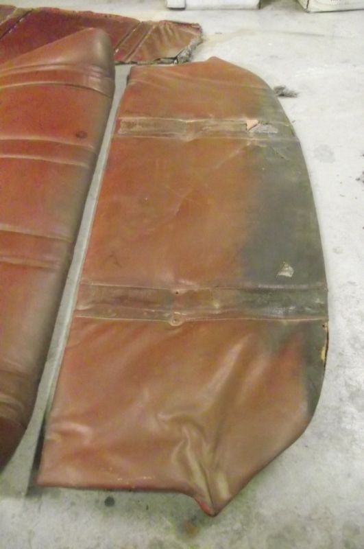

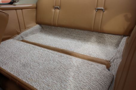

        Thanks for the photos Justin and Drew. It is certainly good to see original items.They confirm what I suspected. also good point on the gear cover. I guess the problem face nowdays when restoring cars we are mostly restoring cars that have been restored before. All of the original are often gone or misinterpreted. Can anyone clarify these images that show vynil (or leather in this image) that is stitched between the carpet in the area between the rear seat back and the rear seat base?
        Thanks in advance
        Jason
