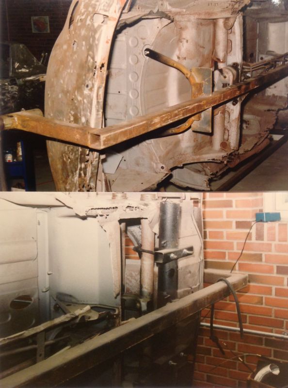

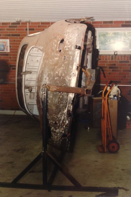

        Hello Guy's
        Thanks a lot for the tips and tricks and of course the pictures.
        I think I'm going to use the "2-triangle with arms" method....and not the overdimensioned creations
        Rear mounted on the 2 points of the hoop
        Front mounted on the tube of the suspension.
        Maybe someone has the dimensions of these?
        I've added some colors and letters to the picture:

          I'll get those rotisserie dimensions, but I think they are on this site somewhere else in another thread, not too long ago.

              So I got another way off hanging a 356 that is really easy to do and less tubes
