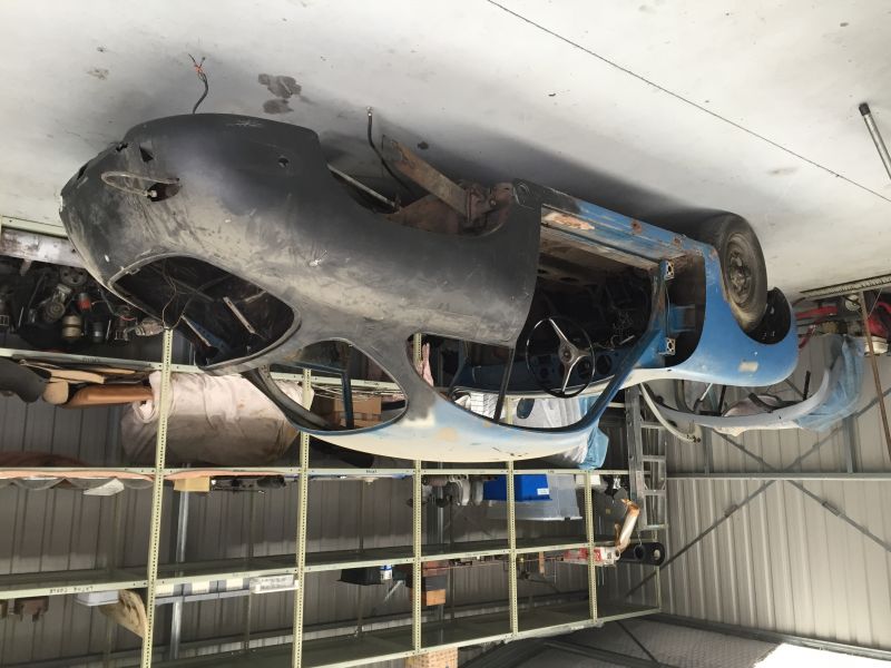

    We are one year or so into an Outlaw build here in New Zealand. The car is essentially a copy of two of Rod Emory's cars blended into one project. I would have loved an Emory car but couldn't afford the folding $$$, so in typical New Zealand fashion we thought we'd 'give it a crack' and build one down here.

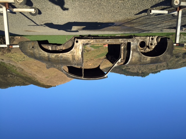

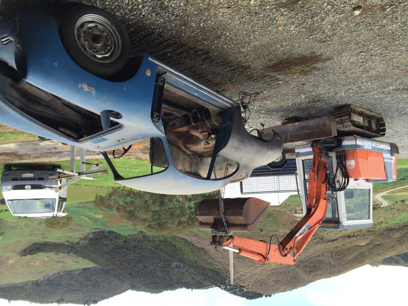

    Started with a 1963 356B T6 Coupe that was found under a mango tree in Hawaii, purchased and rescued the car by good friends up there. The work from there has been extensive converting the car into a Cabriolet and then some. Think the pictures tell the story but 1300 hours of panel work to date.
    The car will run original 356 engine, transmission (12 bolt) and suspension. However have gone early 911 rack & pinion steering for a giggle The engine will be a John Willhoit 2132cc mated to a fully rebuilt 741 transmission. Car has been converted from LHD to RHD, interior will be 944 seats cut down and built similar to early 911 seats. The leather will be Spinny Beck the same as the Singer Porchse.
    Any questions let me know guys. Build will hopefully be finished in 6-8 months.
