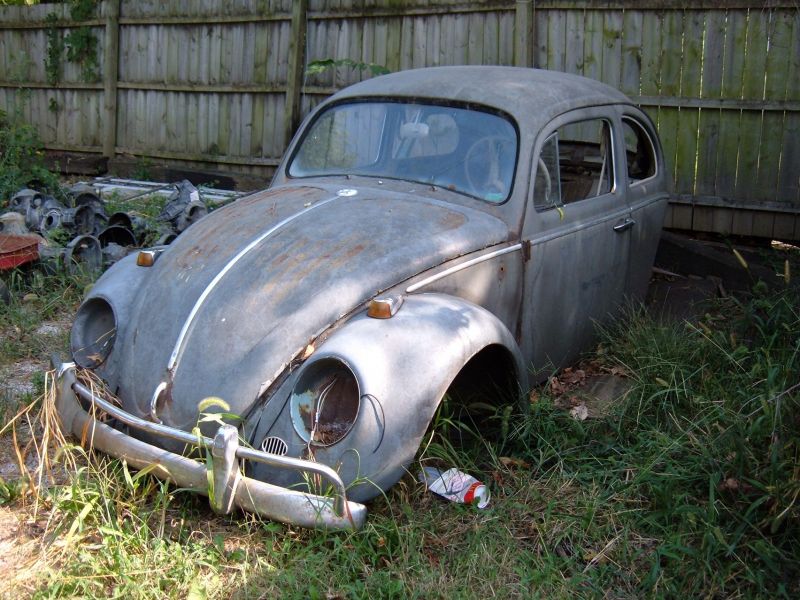

    Here is what I started with... It's a 1964 body that was sitting in a friends back yard for as long as I can remember. He didn't have any plans for it since he started working more on the VW busses. I had a few bus parts he could use so we traded.

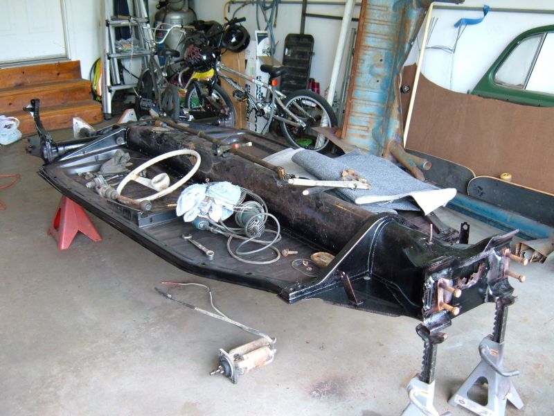

      I used a swing axle pan for the chassis. The Ghia pan that it was first sitting on will be used later in the build.

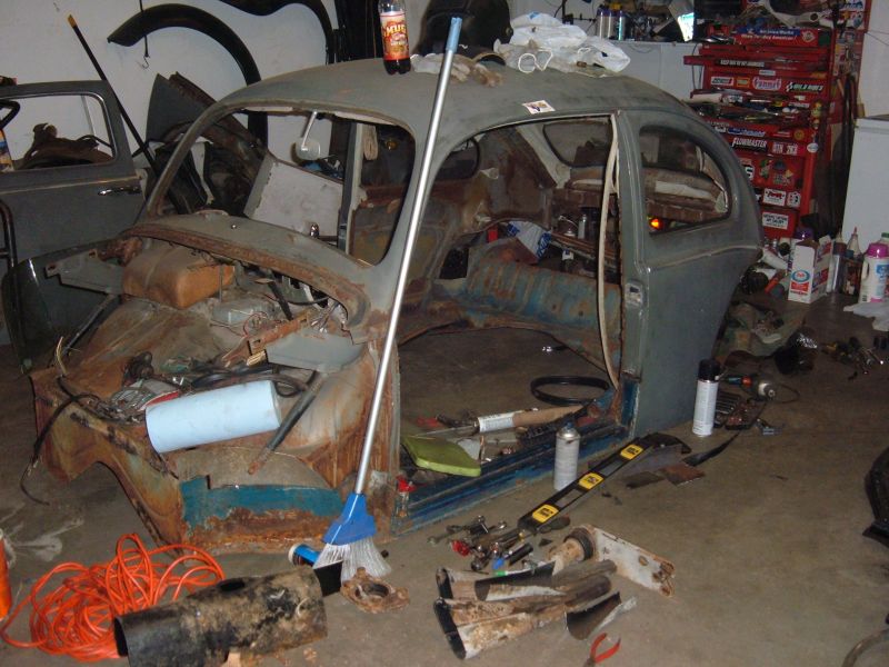

          Since the lower have of the body was rotted out I had this section from a parts car I picked up that was in much better shape.

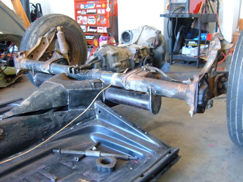

              Raised the torsion housing 4 inches...

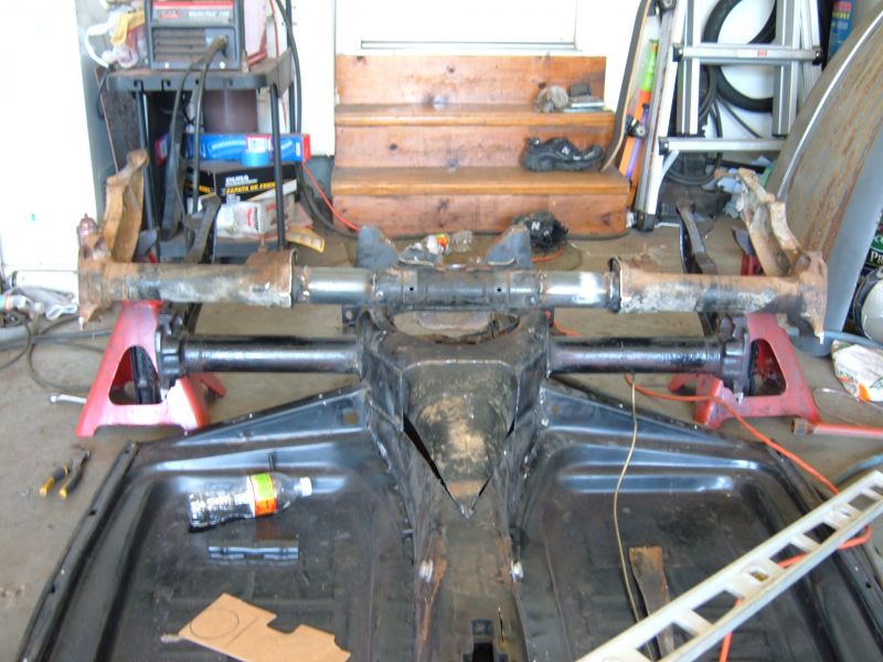

                Here is the Ghia torsion housing after I cut it out of the pan and widened it by six inches so the tires can sit outside the body. I sat it on top to show how much wider the rear will be.

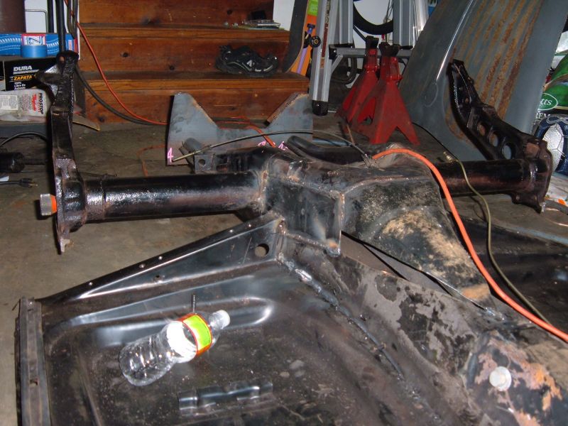

                  Tacked in place, alot more gussets and bracing will be welded on later. You can see how low the car will sitting from the ground.

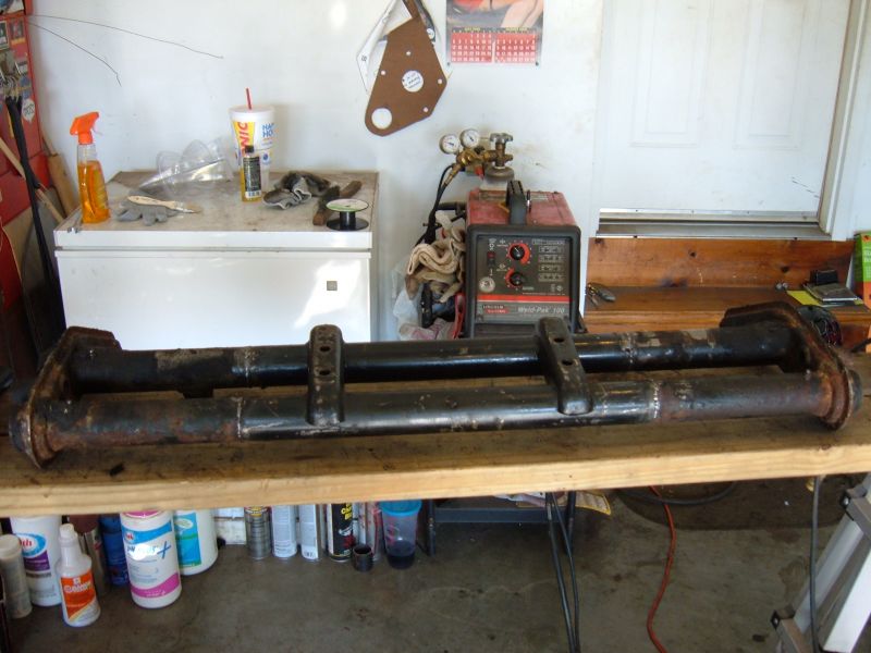

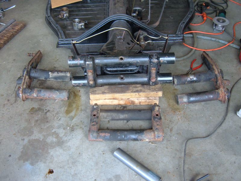

                    I combined two beams to make the front 6 inches wider to match the rear width.

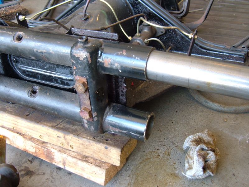

                      Added sleeves to strengthen the tubes...
                        Second beam cut longer to achieve width...
                          Then welded together...

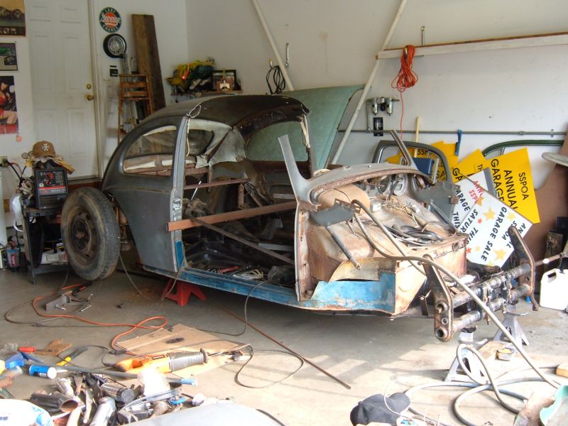

                            Now the fun begins. The body is bolted back on the pan and braced for the chop.
