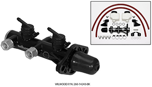

            Has anyone tried one of these? Not sure if it would fit but looked interesting. New offering from Wilwood.
            http://www.wilwood.com/MasterCylinders/MasterCylinderProd.aspx?itemno=260-14243-BK
