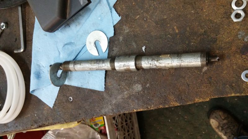

        Found the tool, and right site, as I posted a response on the R forum and someone pointed out the error of my ways. Anyway, just a couple pieces of pipe and connector and 2 slotted washers. Put washers under ends and unscrew pipe till one end comes off. This is a later rod a little larger dia. so does not fit the slot:

          ah, that's pretty simple i'm going to be on it tomorrow.
          thanks very much Jay D.
