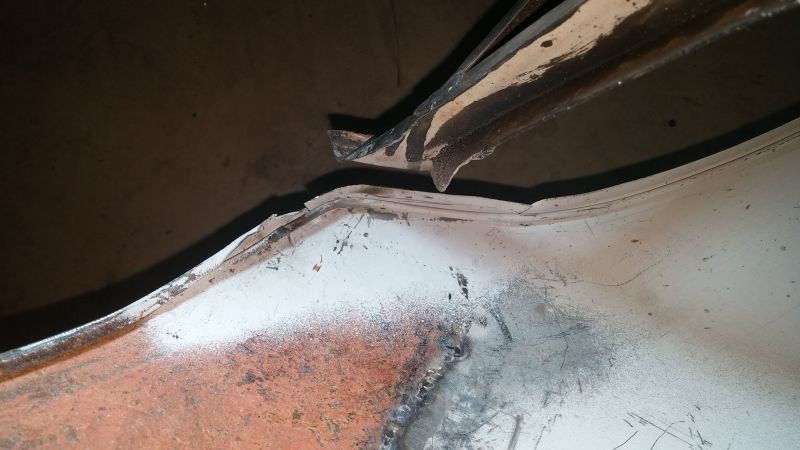

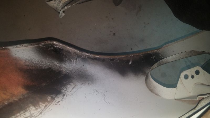

        Drivers side has major problem. All the old accident damage has been a challenge. Need to reshape the area to match template:

          • Dont know why the pics did not display. Deleted them and readded same way as before and now they show. Anyway, need to decide on course of action. A patch piece from a donor nose would be ideal, as you can see other metal in that area is rough.
            • Phil, I see the pictures that match the words. One of those words was "donor."
              I just "donated" a part of a nose to a recycler of such pieces, Ed Anspach.
              https://www.anspachautos.com/
              That pile, picked over by Adam Wright several times, will still yield small pieces such as you need. Ed has been around old Porsches as long or longer than I have. I first met him as a partner in "Anspach und Frick" many decades ago and if what he took from me doesn't include what you need, he may have it from another "stash."

                I have done business with Ed several times over the years. Im going to give it 1 more try, making a wooden form to put behind the metal to try to get the shape back. Really want to get the nose back on. After removing the painted over masking tape along the cut edge, that I forgot I had put there, the metal looks better. Going over to my wood working neighbor to borrow his band saw.

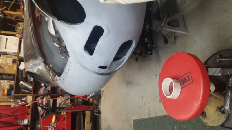

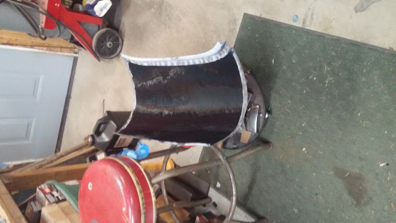

                • Never made the wooden form, but spent several hours trying to get the right curve. Got close, but not close enough. What turned the trick was a narrow piece of pvc pipe that had a tighter radius than the final shape. This worked and now the pieces match close enough:
                  You can see the "tool" lying on the red stool.

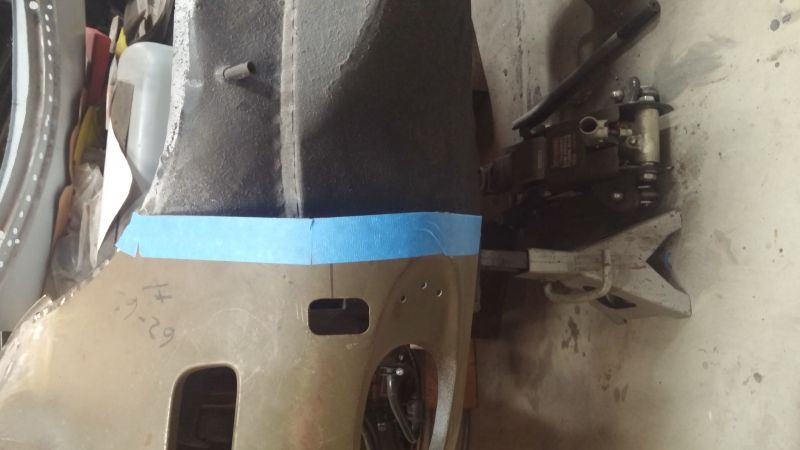

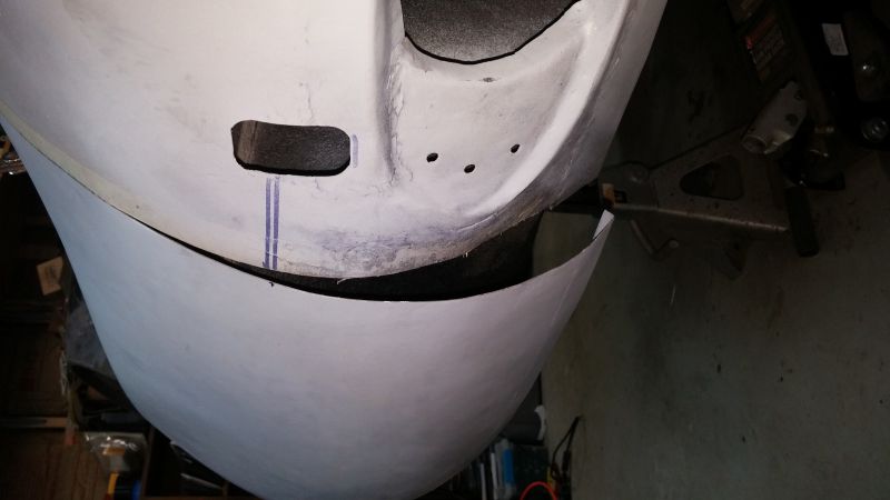

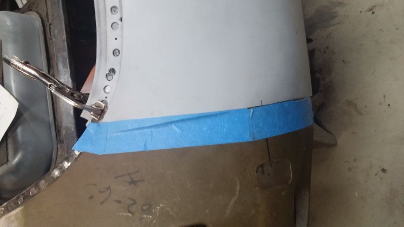

                  With this problem hopefully behind me I had to do some trimming on the other side of the nose to match the nos passenger piece, especially at the top, as the cut I made on the nose was overlapping the new passenger section. Used the trick I referred us to from the metal shapping forum. Put blue tape along new passenger nose edge:
                  Then clamped nose in position and put blue tape matching the left side of other blue tape:
                  Then sccribed a cut line along the right side of tape, removed nose and cut off overlapping metal:
                  No more overlap and nice weld gap.

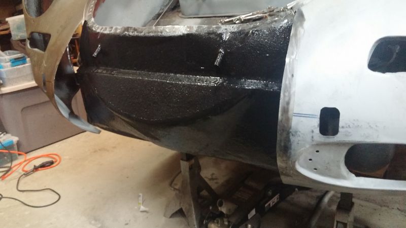

                  Put topcoat on undercoat and inner side of nose piece and removed all paint along butt and spot joints. I did discover an unfixed area where latch bracket welds to nose and the hem was ground thru, so cut that little piece out and will repair before final nose install.

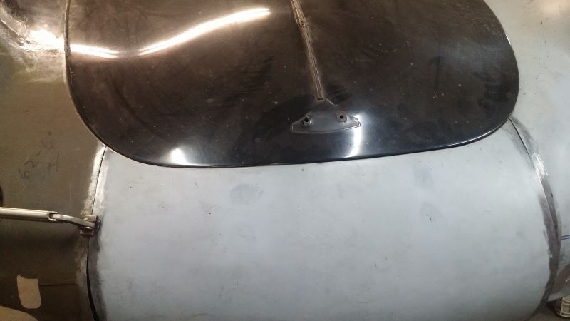

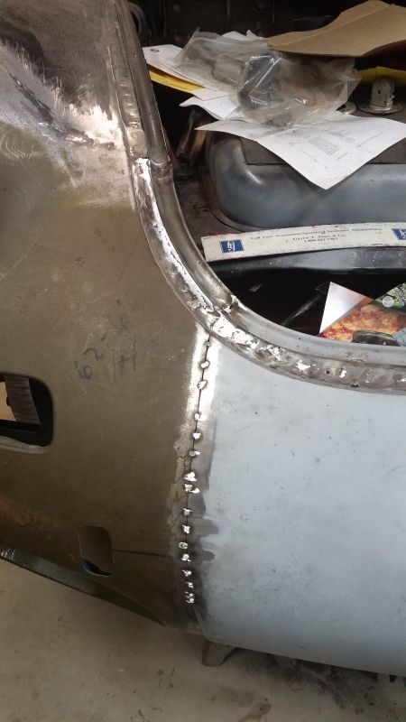

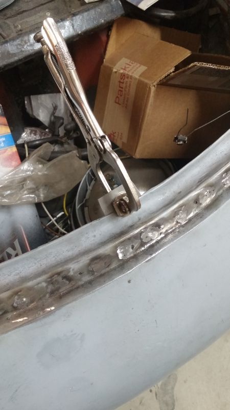

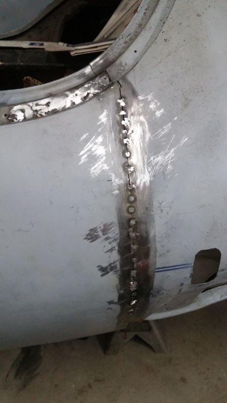

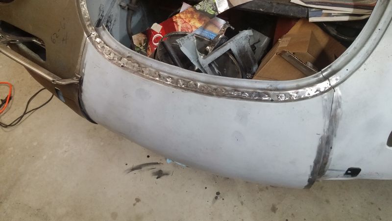

                      • Am commited now. Did all of the plug welds along the top:
                        Tested hood fit before and after. Here is after:
                        Now on to the vertical welds. I checked wheel opening bow on passenger side. That lower corner is pretty stable and does not appear lime it will move much. Still think it might be good to at least tack weld the support braces before starting vertical welds.

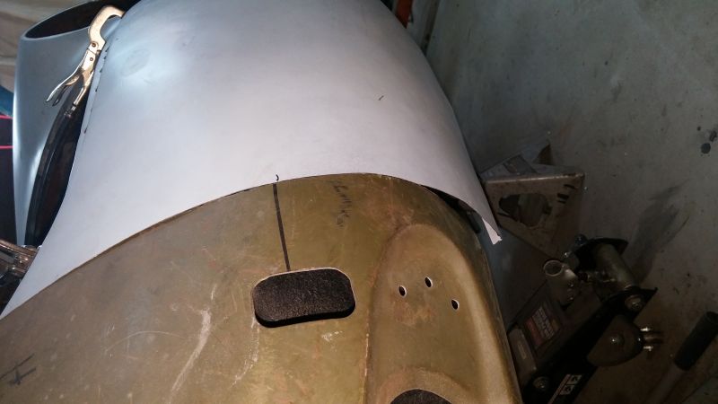

                        • Trimmed a sliver off new passenger nose to refit old channel that has proper profile:

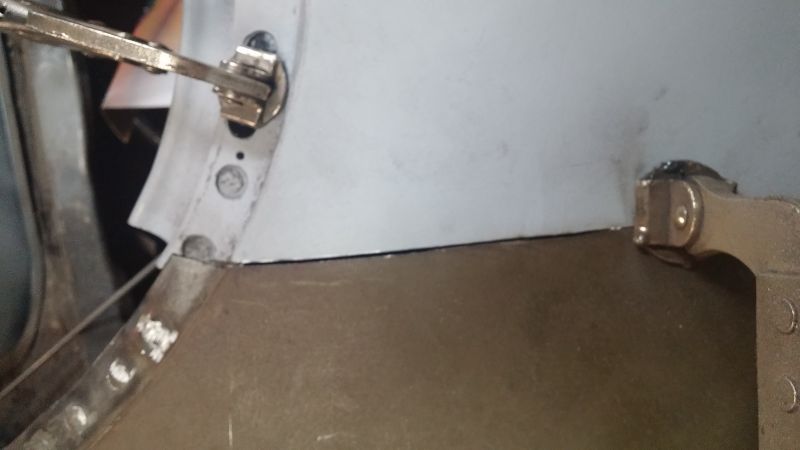

                          Welded in channel and started tacking in vertical joint:

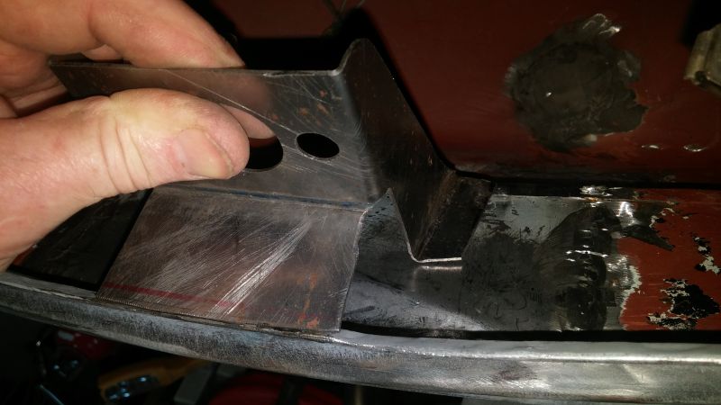

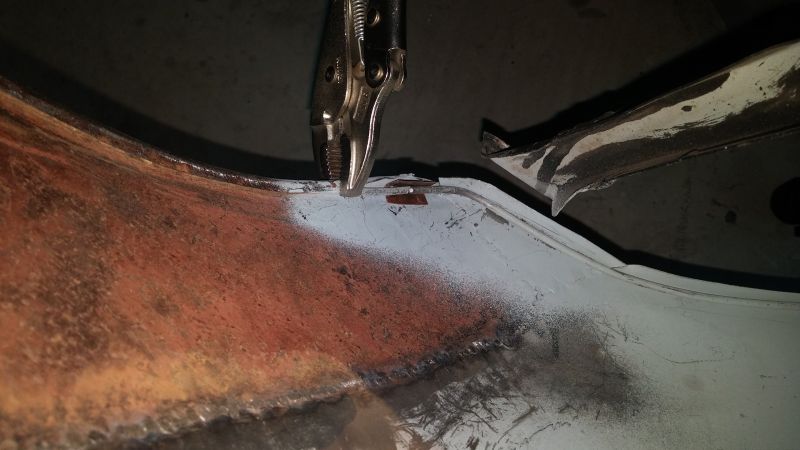

                            Filled in folded flange at latch bracket by welding in larger piece, then trimming flush and welding fold:
                            Check fit of latch bracket:

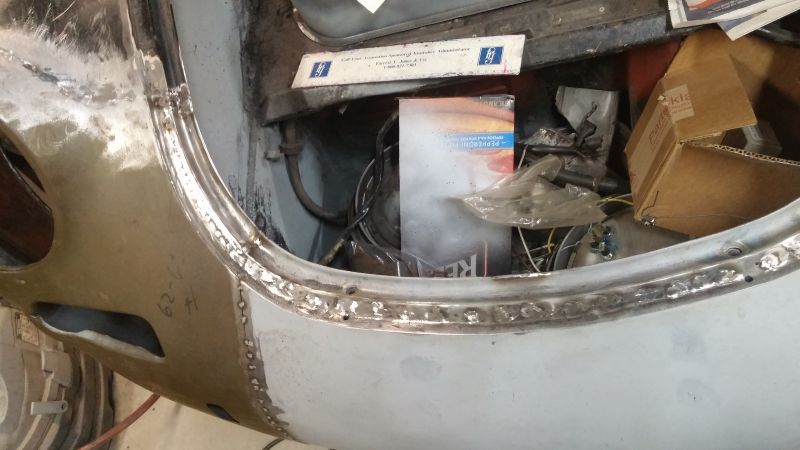

                            Tacked upper part of drivers side nose joint:
