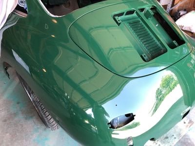

    I can find the web link. Glasuirt has a web site that list all the porsche colors, and formulas for most of the colors in the 22 line. That is the original single stage paint systems. I have done a couple cars with 22 in the past couple years. I like it
    Click image for larger version  Name:	image.jpg Views:	0 Size:	23.8 KB ID:	109779
