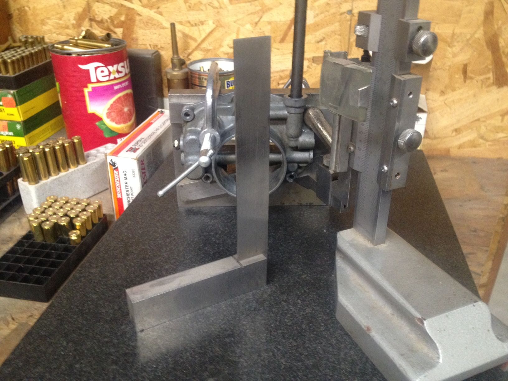

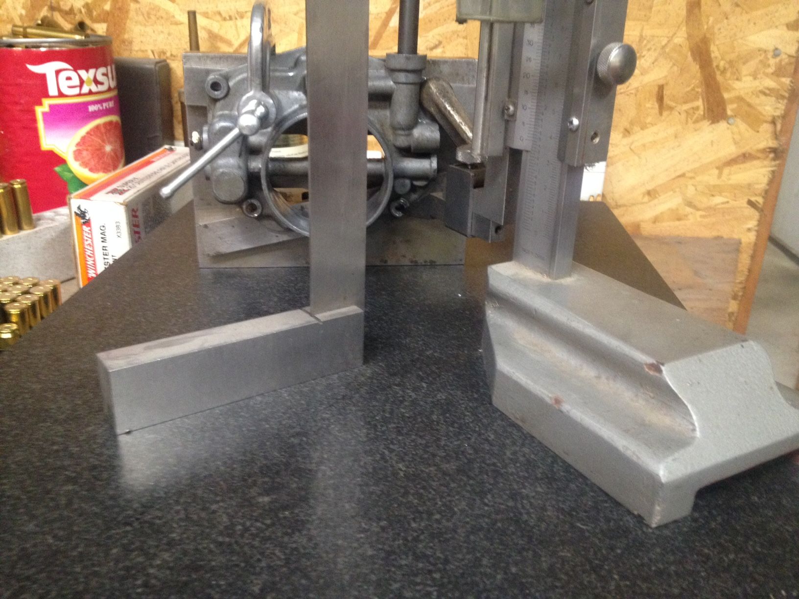

    angle plate and hight gage on a surface plate to align Click image for larger version
    Was not too bad except for indexing the carburetor top to drill the old fitting. We set it up on a 90 degree angle plate and indexed off the bottom two screw holes. Then ran a dial indicator up a transfer punch to insure we were square. The set up is not too hard but its is critical. Insure the carb top is not warped and its is flat.

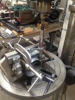

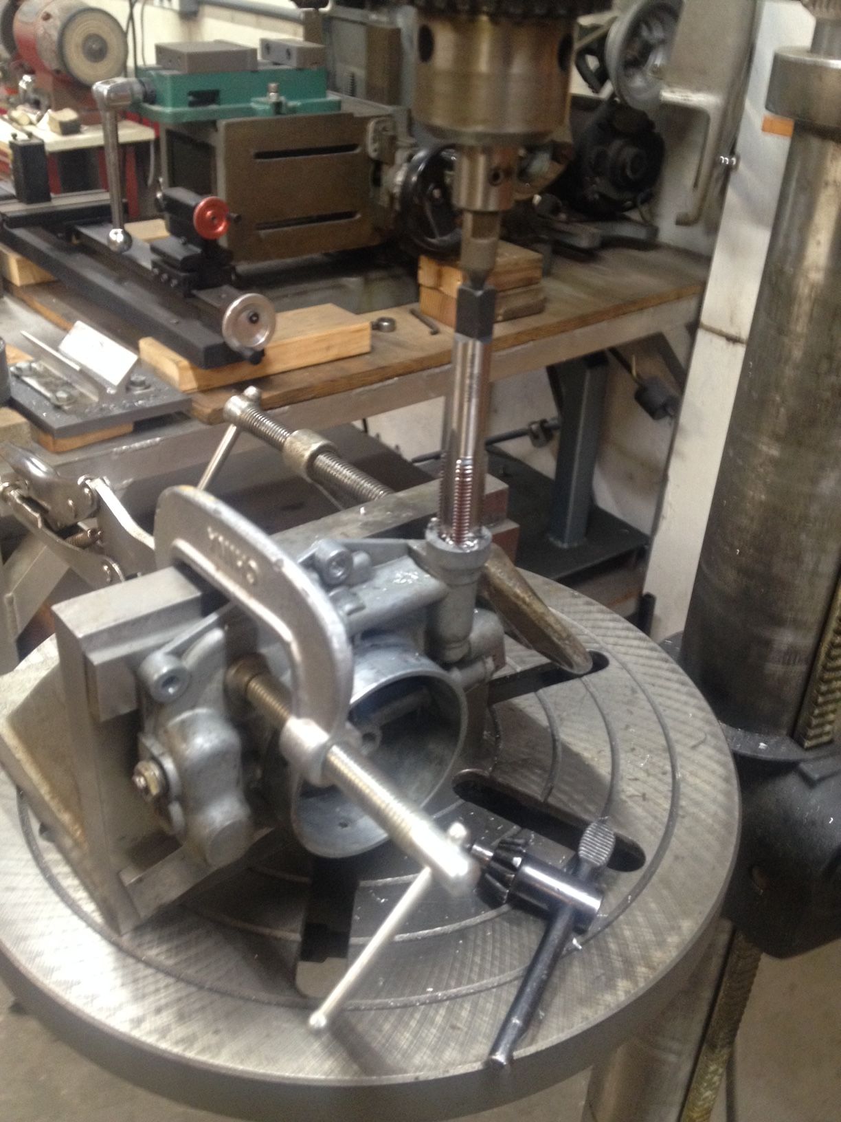

    after drilling the old threads we retapped the hole
    Then set it in the press, indexed off the center of the banjo fitting then bored it out for the insert. We left it locked to the table and re-tapped the hole. We used a spring loaded tap follower to insure it went in true. Then screwed int he heli-coil and it is almost good as new. This will also work for the 5mm top screws but remember they are .8mm pitch, Alignment and set up here is the real trick for getting it correct. A good center finder and spring loaded tap follower will make it almost factory again
