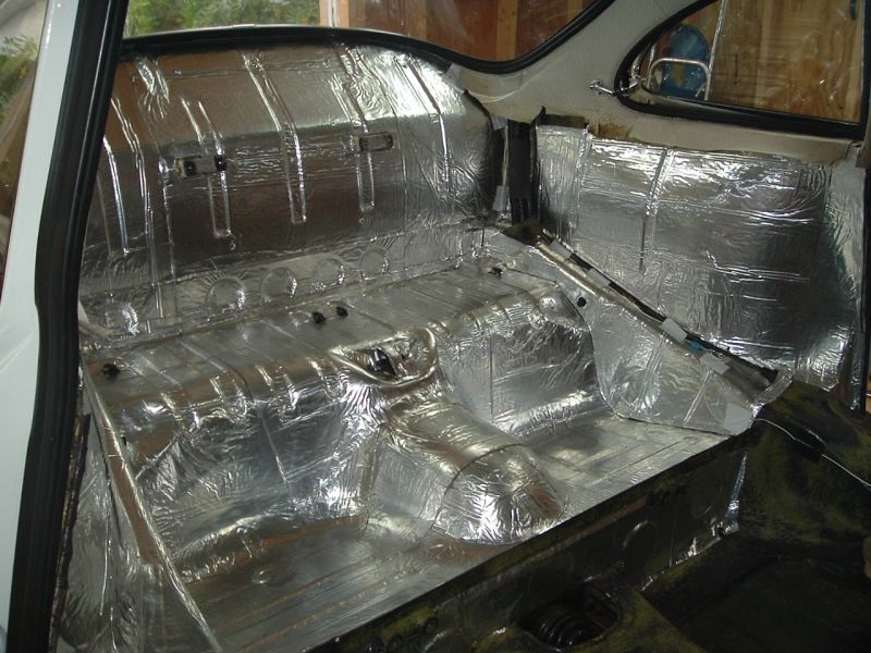

        Yes it's heavy, nothing like jute, but it does dampen the engine noise maybe 20% or a little more by my "ear fatigue" method. I used a product called "Fat Mat", like Dynamat just cheaper, based on a friend who used both. My car is a '65"C" and somewhere down the road ALL engine bay insulation was removed and most of the rear compartment insulation. About the only thing they left alone was the padding under the rear vinyl panel below the rear window. I used Fat Mat on all rear compartment panels up to the shift tunnel. I used jute and tar paper for the firewall in the engine compartment. It made enough difference that my wife will now ride with me!
          Here's the rear compartment of my "C".

            I noticed John Wilhoit uses Dynamat on all the interior panels up to the front footwell. I'm sure his customers expect a reasonably quiet car.
              I'm sorry, I dont get it. Your driving around with you windows down anyway.

                      I'm about to start the restoration of my '64 C Coupe, and this is exactly what i have in mind for my car's insulation. I went to www.fatmat.com to check out this product, and i wonder:
                      how many Sq Ft do you think i might need to do my car? im planning on using this product on the entire cabin: front, back, sides, floors and (sun)roof.
                      They offer packs ranging from 25 to 200 Sq Ft; i might be able to make a guesstimate based on how much you used on the rear of your car.
                      Thanks in advance!

                        Manuel,
                        I ordered 25 sq. ft. of their "Mega Mat" product. I used just about all of it.
