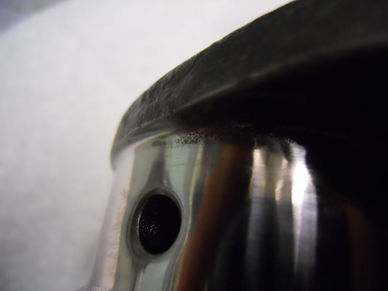

        thanks for the reply Joel, I think that's what i.m going to do. the reason to turn the crank is that I had an engine builder put the bottom end together. then it sat for a few years wrapped with shrink wrap, although it was in a dry shop it must have sweated. the engine builder didn't lube anything other than the bearings. so a small amount of rust formed along the radius of one of the rod crank pins. this left a series of very small pits. the only reason I noticed this, was I had picked up a set of 912 rods to replace the A rods. in doing so I ran into the rust spot.

            I wouldn't worry about those tiny pits for more than a few seconds. Have the surface micro polished/detailed if you like. I'd probably dress those areas with a few swipes of ultra fine crocus cloth and be done with it.
            When the engine is running, those pits will fill with oil with no adverse effects. Any honest high quality crank shop will tell you the same thing.
              The oil hole looks like that crank has already been polished or do they look like that when new?
                yes don it been polished. I had it at a machine shop for a look see and they did the polishing and more or less said run it.
                jack i'm only concerned about this as I have read that these cranks have a nasty habit of braking. I've seen pictures of broken cranks right at the spot were my problem is. could these pits cause a stress riser and promote a failure? I know if it was a s/b chevy or a big inline gmc it wouldn't bother me the least.

                  A small bit of surface pitting isn't a stress riser. With these cranks it usually comes from a grinder not keeping the correct radius in the corners.

                    I'm with Jack, sort of. I would polish the pits out, locally, with rubber wheel on a Dremmel tool, to be sure they can't become a stress-riser, then micropolish all journals. Be sure to clean all oil passages, removing the aluminum plugs for access with pipe cleaners, or similar. Many expensive overhauls have been ruined by dirty oilways in the crank.
                    Gerry McCarthy
                      Joel is right. You are at greater risk from a poorly-done grinding job, than from those pits, but, they're easily removed, so, why not? Regarding magnaflux, a good idea, but, no guarantee in the case of these cranks. I've seen them break within 2000 road miles. It can tell you it WILL break, it can't tell you it will not.

                        Jay, your pix don't show enough to determine what type of crank you have. Earlier cranks are not cross drilled, and do not have blind holes and plugs. It's good that your engine was built as a "normal" originally. The lower redline substantially reduces stress and flex to the crankshaft. These problems increase exponentially the higher the rpm's. I wouldn't hesitate to use it in a customers car, unless the engine was highly modified.
                          it must be an early one as it has no plugs. it has this number stamped on it 828860. Thanks gentlemen for all the input I think its going together as is.

                              Roy, maybe you didn't see that he says this crank is at STD, never been turned, so the nit riding has not been cut into. Thats a good recommendation at 3rd under, maybe even 2nd if something is questionable about the crank.
                              Jay, that amount of corrosion is nothing. Follow Jacks recommendation and go with it. It will be fine.
