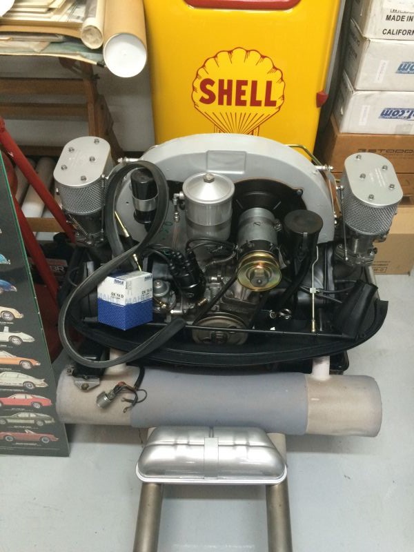

        It's for a fresh restoration of my 62 S90 cab.
        Engine has 912 heads, 86mm Nikasil lined alloy mahle cylinders, forged JE pistons
        He wants to add as an auxiliary pump during start up. Also stated especially longer start times with ethanol based fuels. However plan to use ethanol free fuel.
