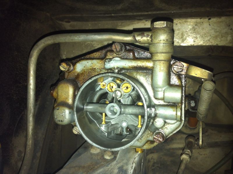

                  I'm pretty sure they are zeniths. I don't see a name on them but from a pic I found on google image they look right. I had them rebuilt 15 years or so ago.. Hopefully in the next day or two ill have a chance to find an assistant and check the pump

                  Is a rebuild an "expert" job or could a person without experience pull it off successfully?
                    Greg,
                    You do have Zenith carbs. Before you strip the fuel pump check the delivery it well might be okay. If you have to renew the parts in it that is possible but apart form the diapragm there are small valves in the body as well. The stroke of the pump is governed by a rod that pushes onto a cam on the distributor drive and that moves the diapragm to provide the pressure. You have to get that movement distance correct and many use a special gauge to do that.
