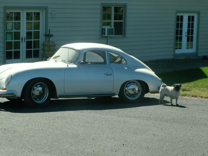

    I attached a (very dusty)pic from a couple years ago (cause everybody likes pictures)
