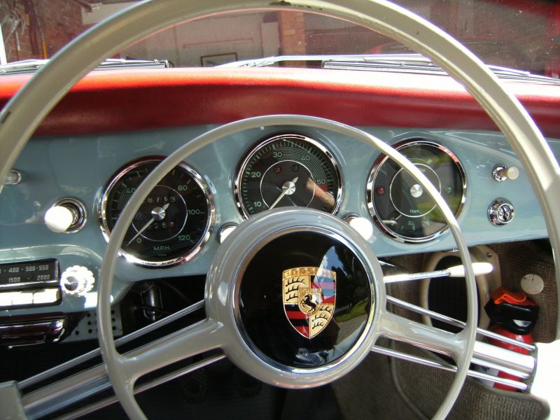

              Clocks were available but a big decision to cut the hole! Also on 356A T2 cars the instruments do not contact a flat face. They have a formed shape around each hole. So again it makes you think it was not available fitted by the factory. You can see the raised lips around the instruments on my photo below:
